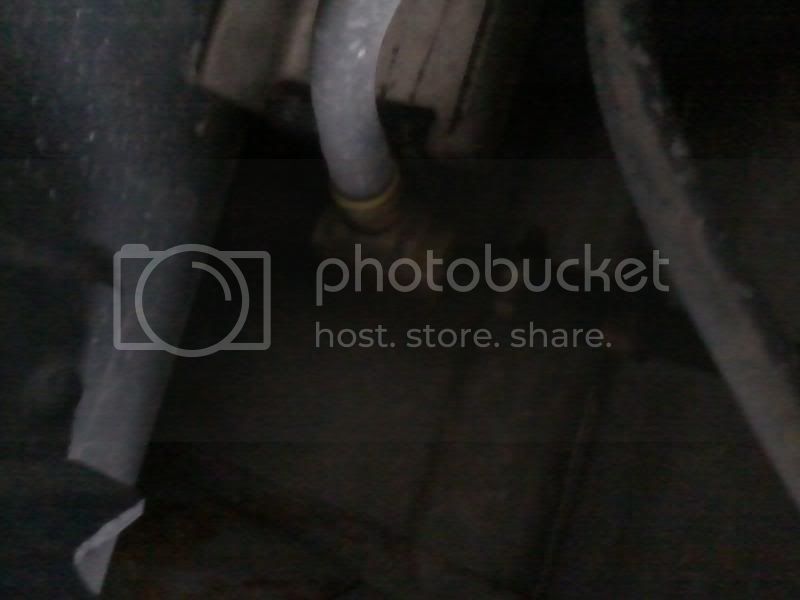

Ive got a 30 gal tank im prepping to install. Im having a hard time finding a straight answer on what size the filler neck is on these trucks. Ive heard the ID is anywhere from 1.25" to 3". If I cant find the answer, I'll just snip, measure then go to the store, but it sure would nice to have all my parts in advance. TIA for any answers.

ID of fuel hose coming off the filler neck is 1.5". Thought I would add incase anybody is looking for this answer in the future. Cheers

Run it to the vent line. By the parts at the hardware store.
I put a 90 in my truck a few weeks ago. This is the 4th one I put in and the first through the vent. I won't install them any other way now.
Get a 90 from the tank, little valve, hose barb to size of line you like. I used 3/8" this time.
Get 1/2" hose barbs and tee along with 1/2" hose barb to size of line you run.
Cut vent line and put in.
