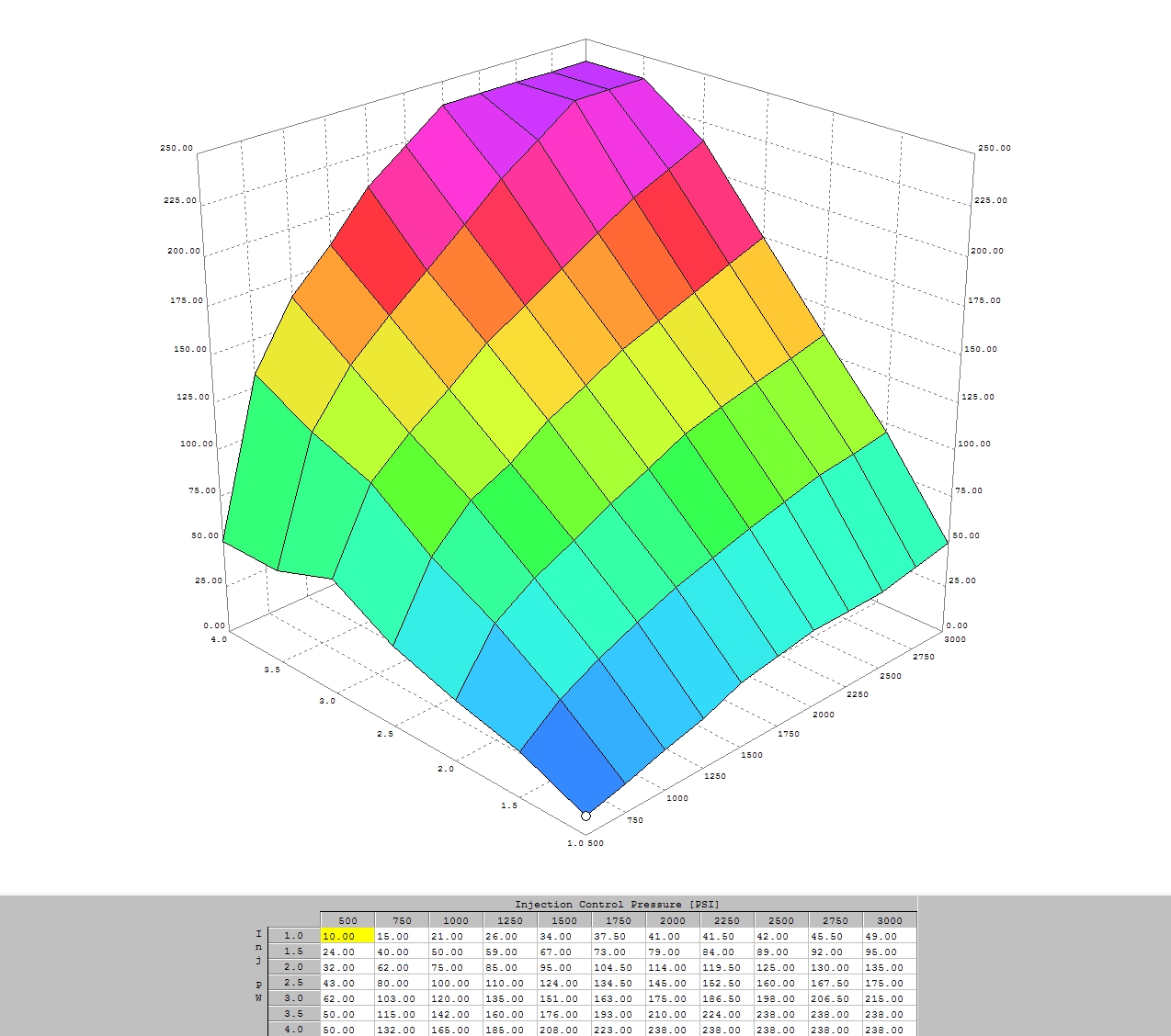

In explanation of the attachment:
Where a stage 3 (238cc - 80 %) will deplete at 3.5 ms of pulsewidth, this is at 3,000 psi ICP.
With only 2,000 psi ICP, it will require 4.0 ms PW to deplete the same 238-80
