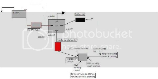

Here's the wiring diagram I used if it helps.

Man I shoulda stayed mechanical. I'm an idiot when it comes to wiring anything. That diagram doesn't even make any sense to me.
its a picture of the bottom of a common 30amp relay with matching pin numbers that are written right on the relay, nothing tricky or hard there but you have to try at least a little
