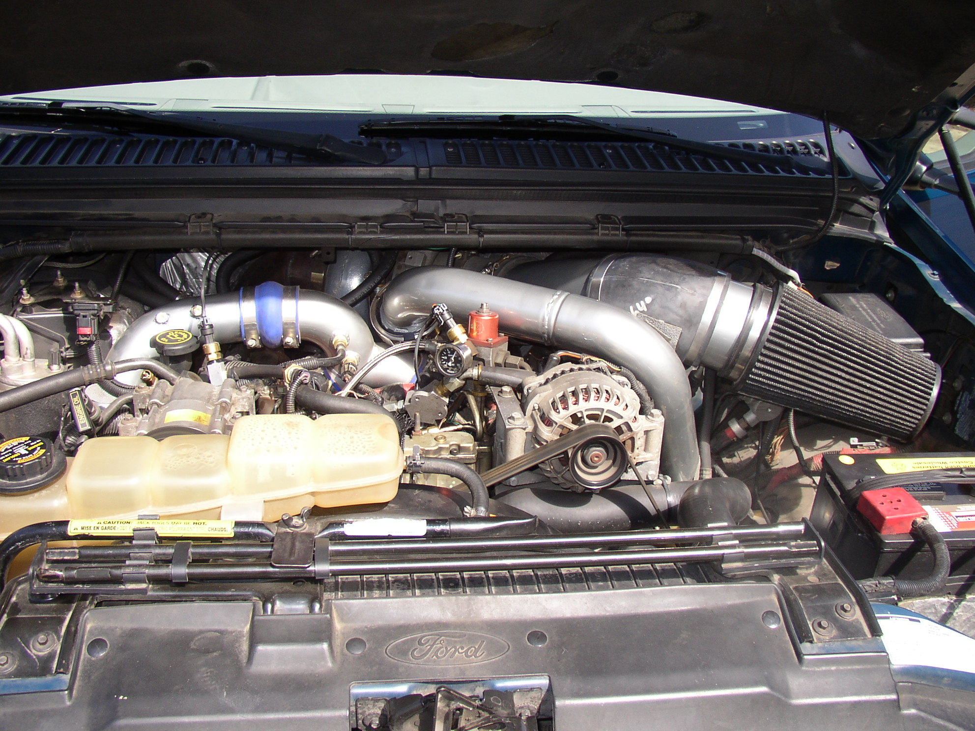

physically, a GT42 is pretty big compared to the stocker. 5" intake plumbing is pretty hard to make look stock.
Absolutely I do not disagree but my thought is that this may one be true when you have a stock one and the other side by side. Just saying diesels compared to gassers are 1:100 in most areas and then how many are experienced with 7.3s these days well enough to know what size turbo and is that what they are even looking for. Mostly it seems the attention is on emission equip itself Is there a CEL is there is a cat and muf. I am lucky here as out air quality is some of the best and we do not have emissions on any vehicles in this county and not on diesels in the entire state. Nor in the areas that do have it on gassers is it state run but local gas stations are the E stations so even then its not hard to find someone that knows someone that knows someone:cool:
