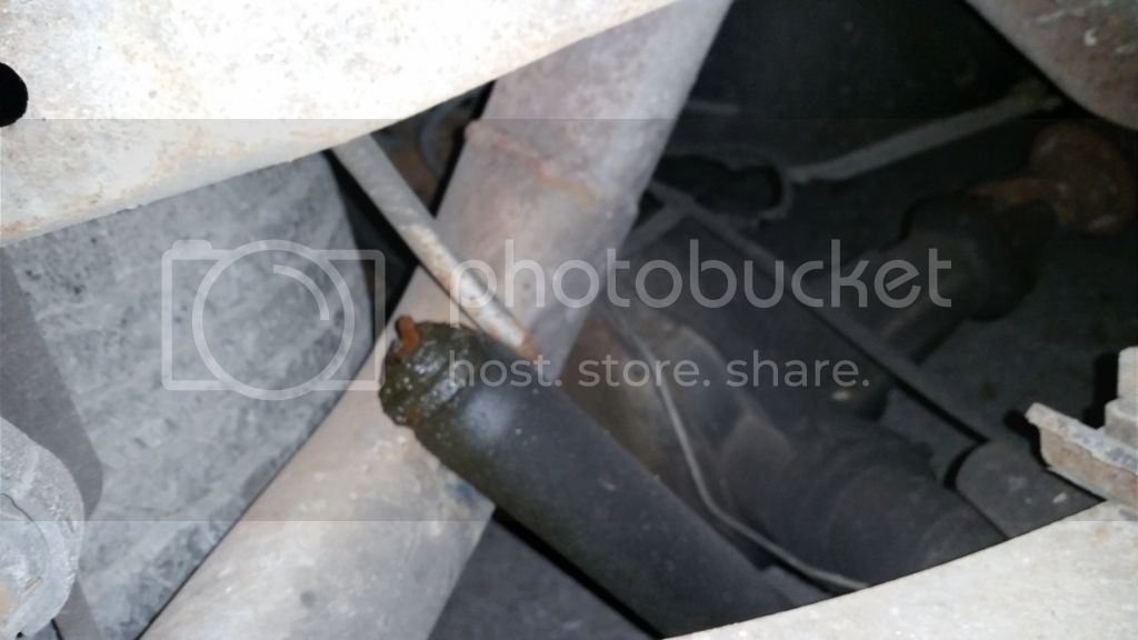

I have basically have a full leaf lift, truck really rides extremely hard and I feel absolutely no suspension action at all. The shocks all around are rusted through, and I had one snap today when I loaded the bed. Am I even getting any sort of benefit from having them?

yea, I understand that... but I dont think I have much of either LOL... this thing is brutal

Get rid your your crappy springs. Then put better shocks.
Even with your buckboard ride. The shock still do something.

Put some fox 2.0's on there. There was a noticeable difference on my dad's full leaf spring super duty when we put them on there, still a rough ride but took some harshness out and more controlled.

What options do I have here with springs? Im def not going to a smaller spring pack with blocks. I like the fact that this truck can take corners like a sports car, I feel Id lose that with a softer spring.
I will look into these 2.0s.

A softer spring with the right shock will still corner really well, but it won't feel like your riding a farm wagon around town.
That is how my 350 used to ride and i thought it was worth it to keep the way it handled. Then I rode in a carli suspension truck with either Fox or King shocks(I don't remember which). Completely handled the same, but the bumps that had me bouncing off the seat would just make the truck move a little and that was it.
I am not saying everyone should go with carli, just that you don't have to have that harsh a ride.

Two philosophies on cornering. Stiff springs with a small sway bar or big sway bar with lighter springs. Shocks control the spring rate. If your springs have a high spring rate, which it sounds like they are, you need a stiff shock.
Most of your cornering will come from the front. You could leave the front like it is and soften the rear some and I bet you wouldn't notice anything in corners but just a better ride over bumps.
