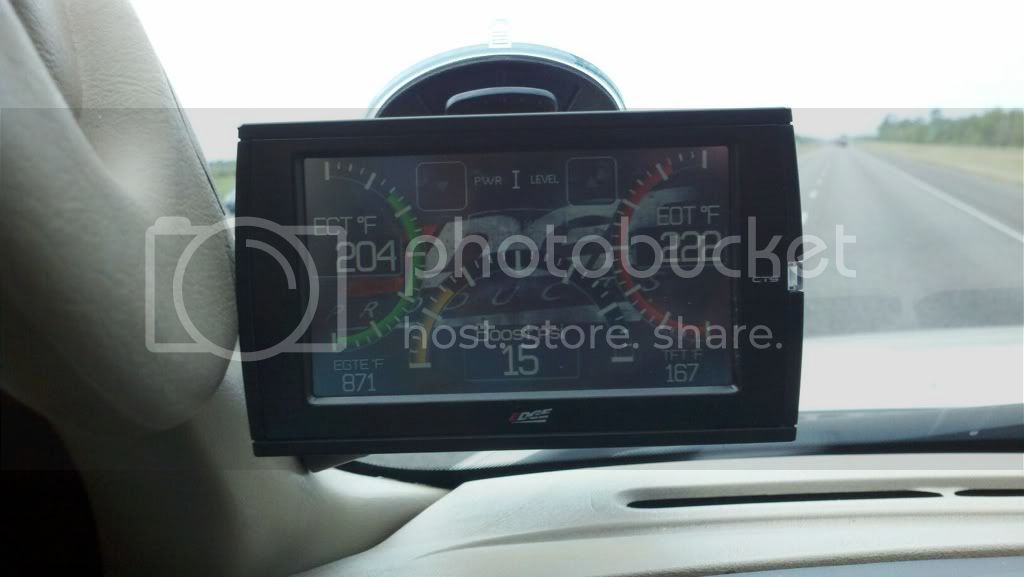

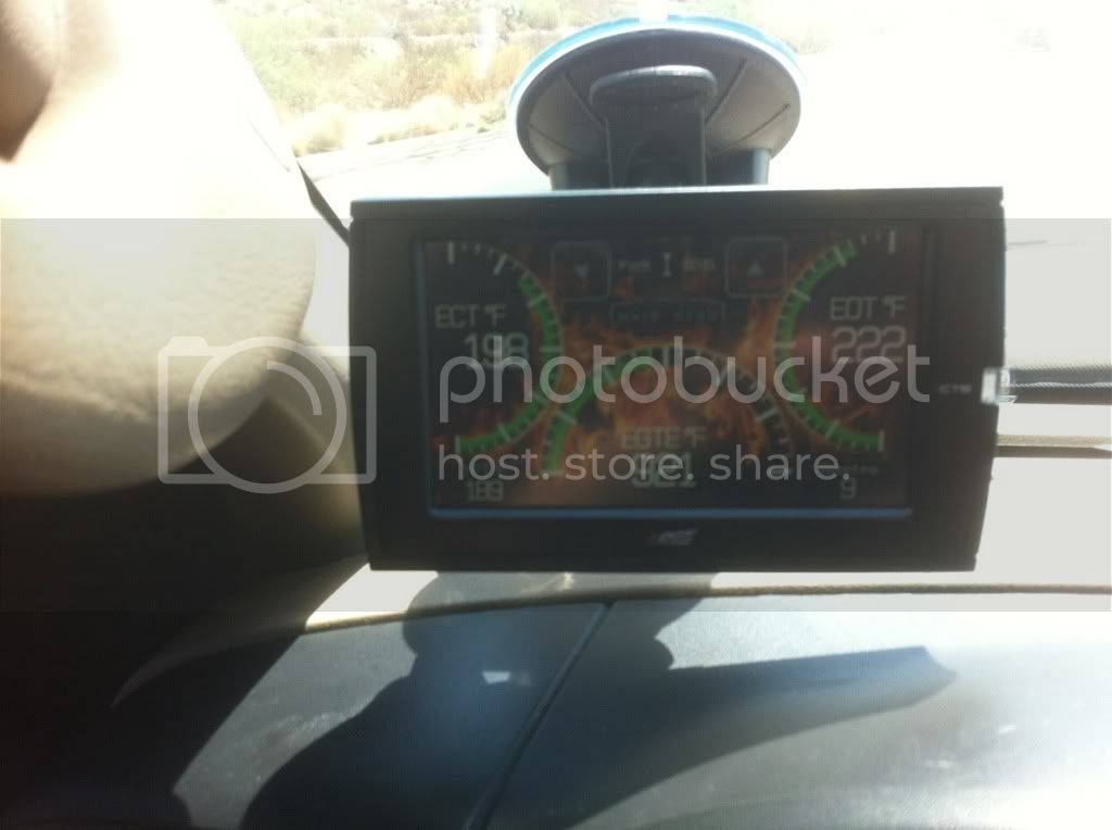

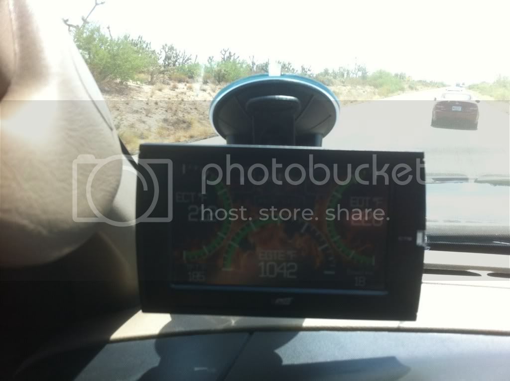

Driving around I will see anywhere from 185-205 ect and 190-225 eot. It just depends on the outside temp and how hard I'm working the truck. Here are a few pics.

So have Picts and vids of cruising around 70mph no trailer or load and hitting those temps and more. I have a vid almost a min long of a steady 40* difference.
