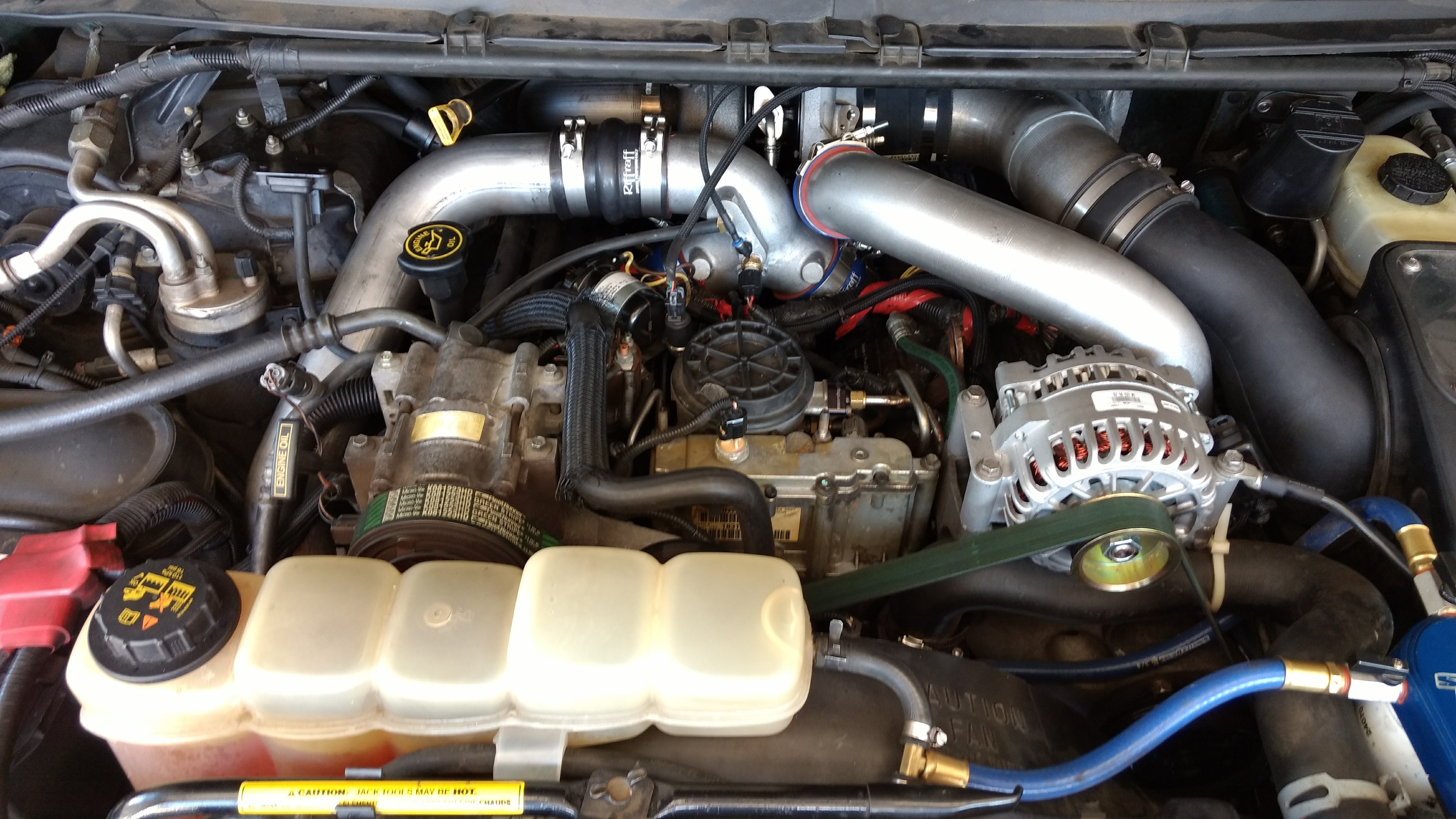

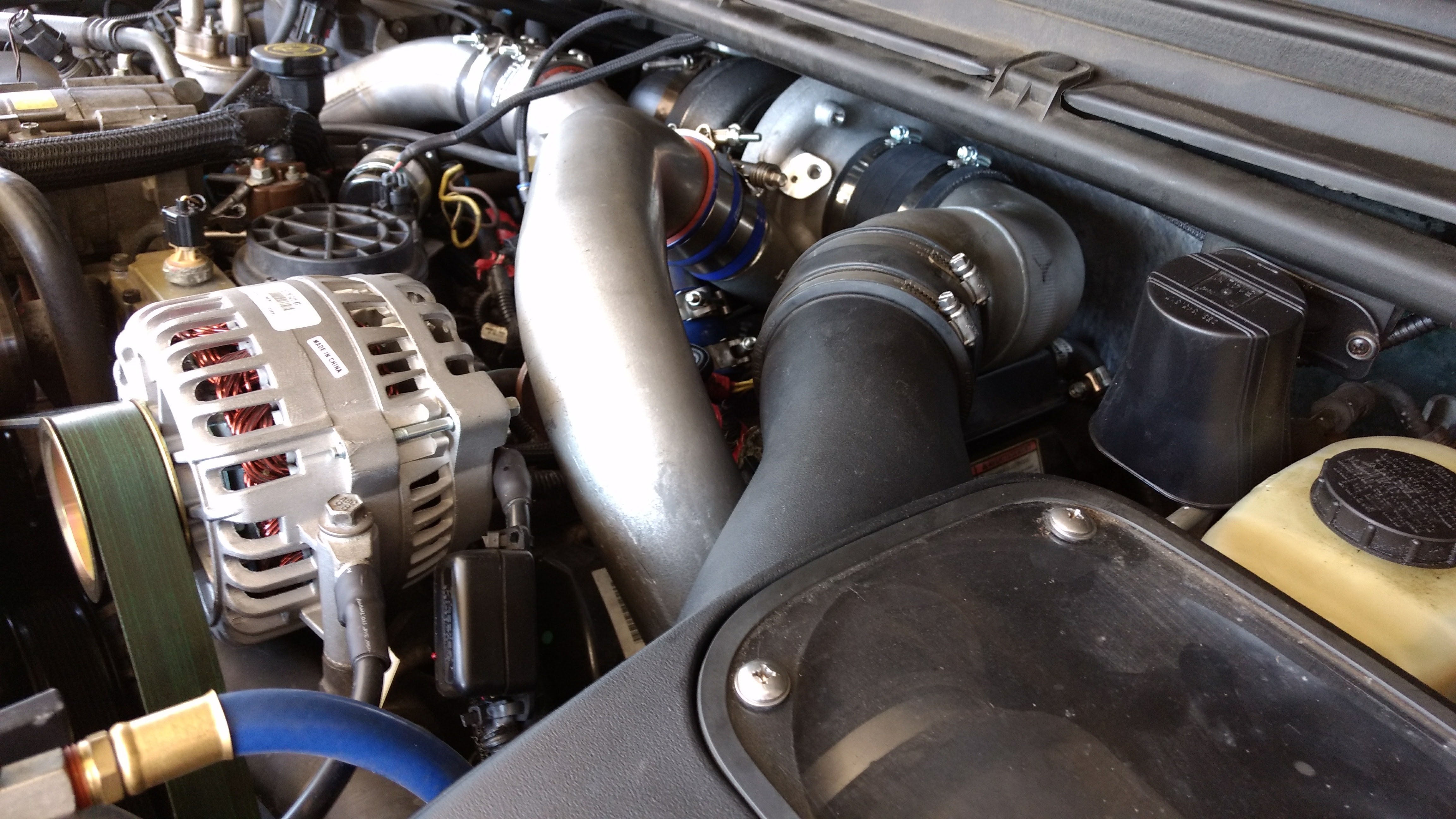

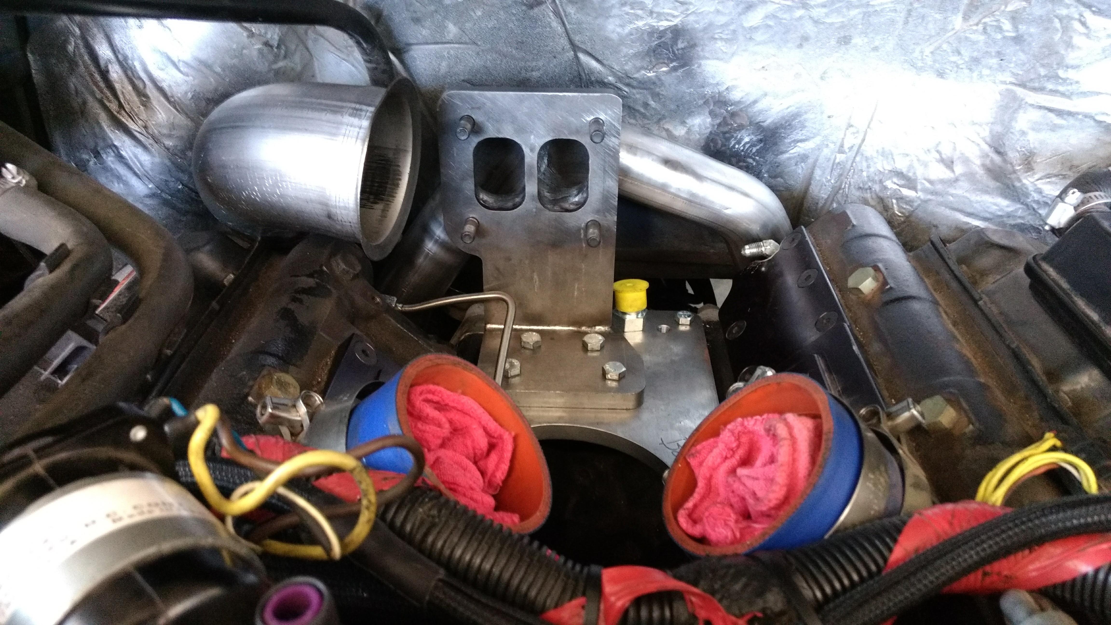

Installed the turbo this weekend. Everything went in well with a couple exceptions. 1) The down pipe doesn't line up good enough with the 4" exhaust I have. I removed a 4' section of the exhaust so I could install the supplied down pipe. It will need to go to the exhaust shop which is not unexpected. 2) the down pipe clamp sent in the CSD kit via DP Tuner was way to large, they didn't check it apparently as it's probably 1-2" too large. The stock clamp was used instead but it doesn't fit correctly either so hopefully the exhaust shop will have one that fits. I'll Reach out to DP Tuner to see if a replacement can be sent. Other than these two things, it all went smooth. Got the supplied 4" mandrel bent/welded intake tube trimmed in nicely with my new style S&B intake. Took it for a drive around the block and seemed fine, just loud with only a down pipe so I can't tell much from that short loud drive.

I used a piece of SS flex pipe to go from the down pipe to the exhaust. Mine also came with a 3.5" down pipe, and I used an adapter to space it out to 4", then flex to the pipe. But I built my complete exhaust from parts because I wanted to keep it quiet. In the cab its near as quiet as stock, if not the same, and I got rid of the drone.
When you say the down pipe clamp, are you talking about DP to turbo clamp? Or exhaust clamp for the pipe itself?

It is the DP to turbo clamp. CSD is shipping out the right one today, DP assisted with this so it should arrive pretty soon and once the DP is clamped down properly, then I will tackle the exhaust connection.
