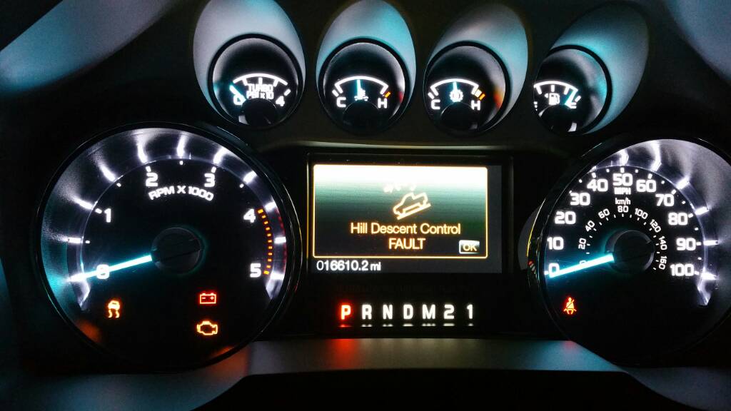

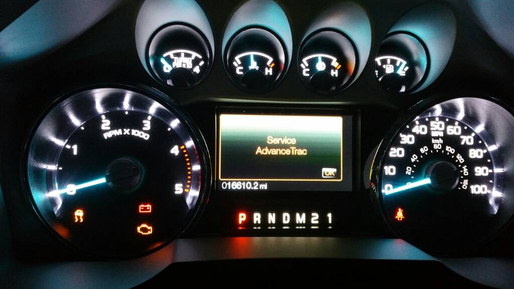

These warning lights came on the other day as I was pulling into the parking lot at work. Truck drives perfectly fine. On the drive home the lights stayed off until I pulled into the neighborhood and was almost at my driveway. Both times I had been on the highway cruising 70mph for 18 miles. I called the dealer and got an appointment set up to drop the truck off. Anyone had any similar issues? Truck is a 2016.

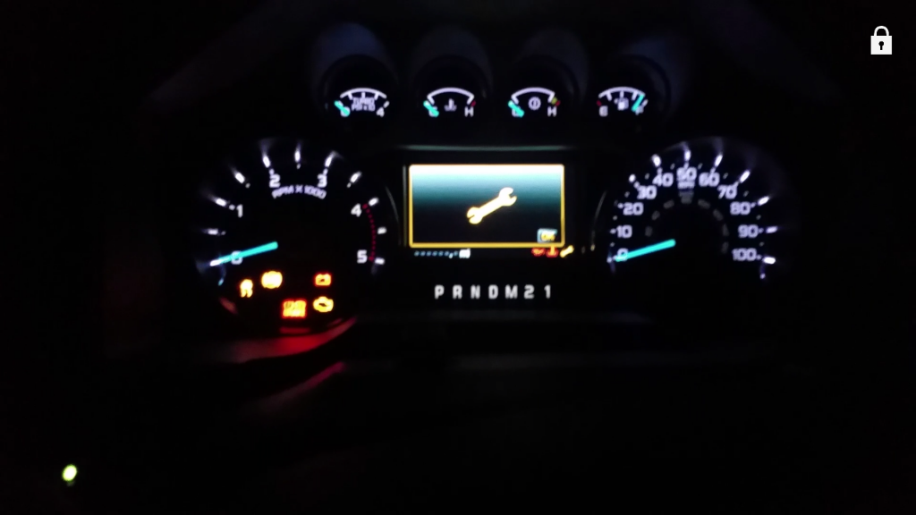

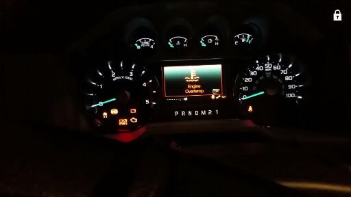

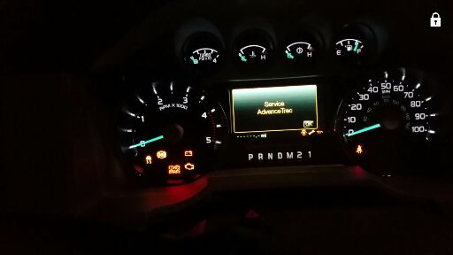

Looks like my truck is going to the dealership today. No clue wtf is going on. Took a couple of videos of it to show to the service techs when I get it to the dealer.
First two pictures I was doing 70-75mph down the interstate.
The other two pictures the engine wasn't even running.

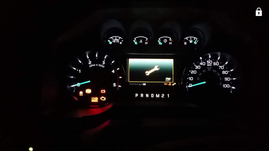

No. When I left work today everything worked normal with the exception of a check engine light. Hopefully it will stay on long enough for me to make it to the dealer tomorrow afternoon and they can get some info out of their diagnostic equipment.
Screenshot of the video I took as I was leaving work.
