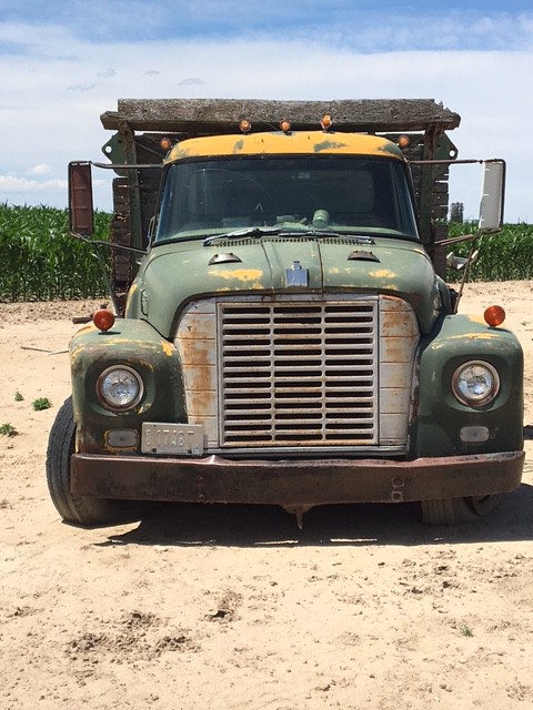

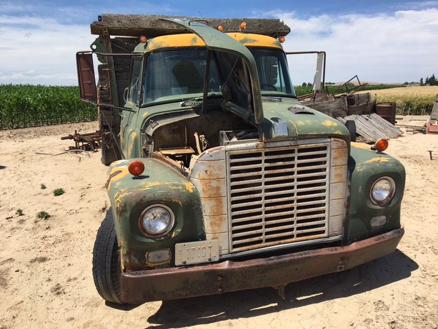

Well here she is, 1967-ish Loadstar 1600. I still havent decided what truck frame I want to put this cab on yet. Still looking at all my options. I think the patina and odd door make this cab pretty ratrod eligible; just something different not everyone has.
IMG_1139
IMG_1149
IMG_1140

Cough....dt360.....cough cough
Anxious to see where this goes.
