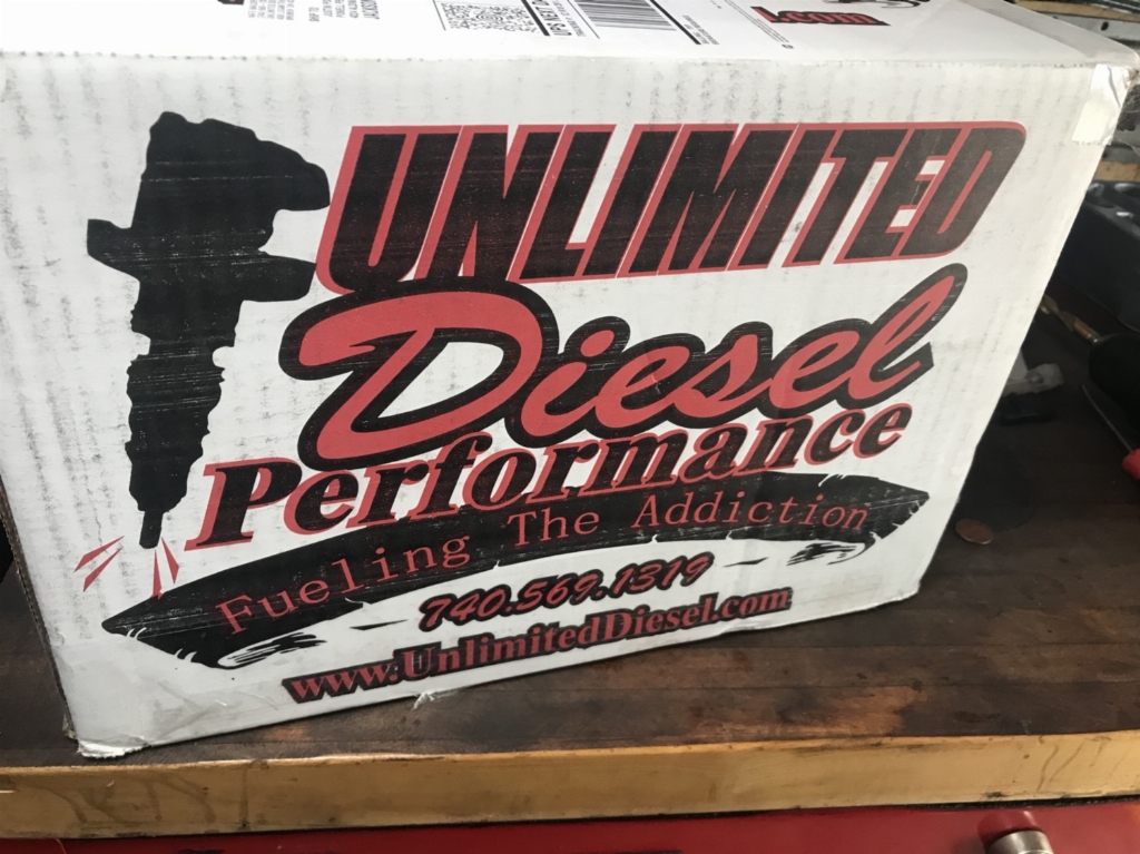

Swamps was 3 weeks out to build the injectors so we went this route icp is up at 2200
lincolnlocker
27,858
144
Central Michigan
Oooohhh, you got Nate's injectors from black cloud. Thats good. Just didnt know who black cloud was. Ipr dc is a bit high but it should still fire at that icp. If no wts light then it might have a bad reading from pcm. How are the batteries and alternator doing? What is cranking voltage?
