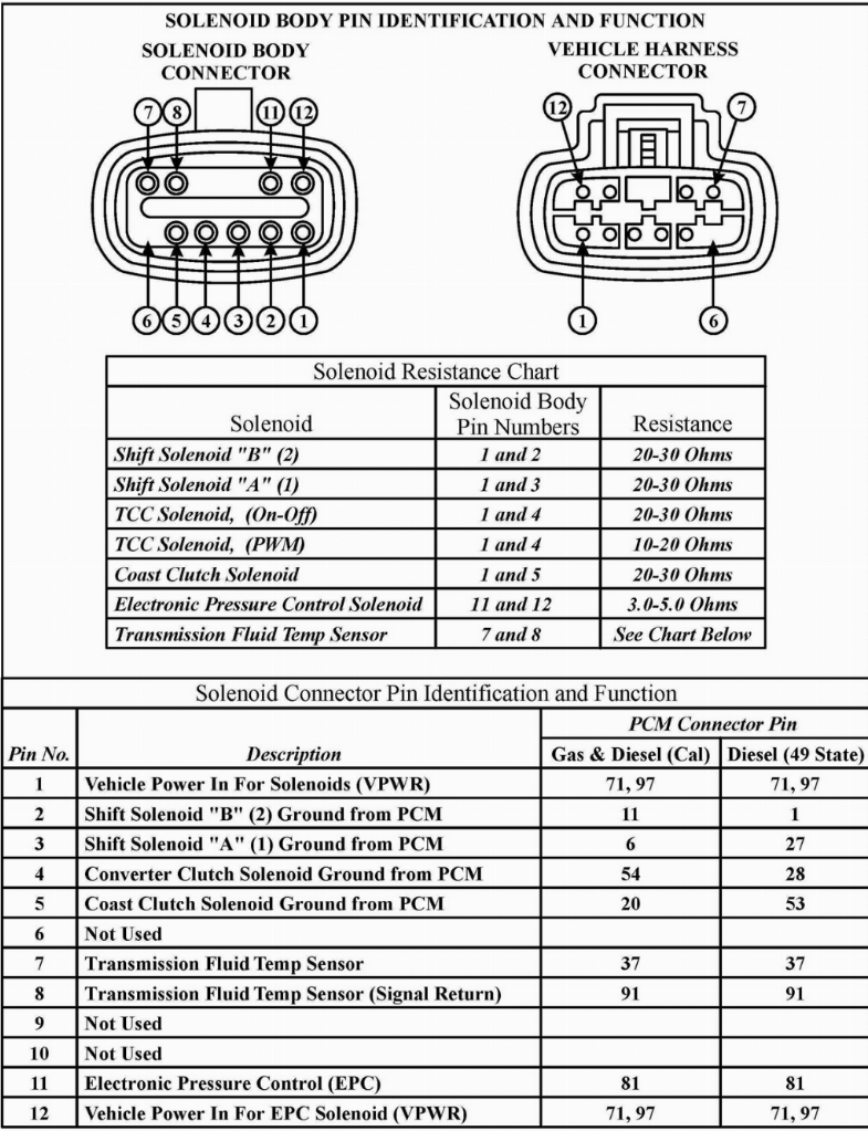

My 2000 7.3 4r100 the torque converter locks and unlocks while accelerating and driving in OD. I have ohmed out the solenoid pack and wires going to it. I have replaced brake light switch, tail light bulbs. Can’t find anything anyone have any ideas. I am leaning toward PCM or solenoid pack it’s self.

When you homed our the solenoid pack, what did you get?
I believe 4r100 uses the speed sensors on the transmission itself for lockup (along with pressure fluid coupling etc). Could you ohm them out too? 1.10 ohm

They are not slipping it is locking and unlocking several times with in a few seconds I have a snap on Solis scanner and you can see it doing this.

Not solenoid since it ohms out fine. Not tc b/c you locked it manually.
Pcm. Get it rebuilt by swamps.
