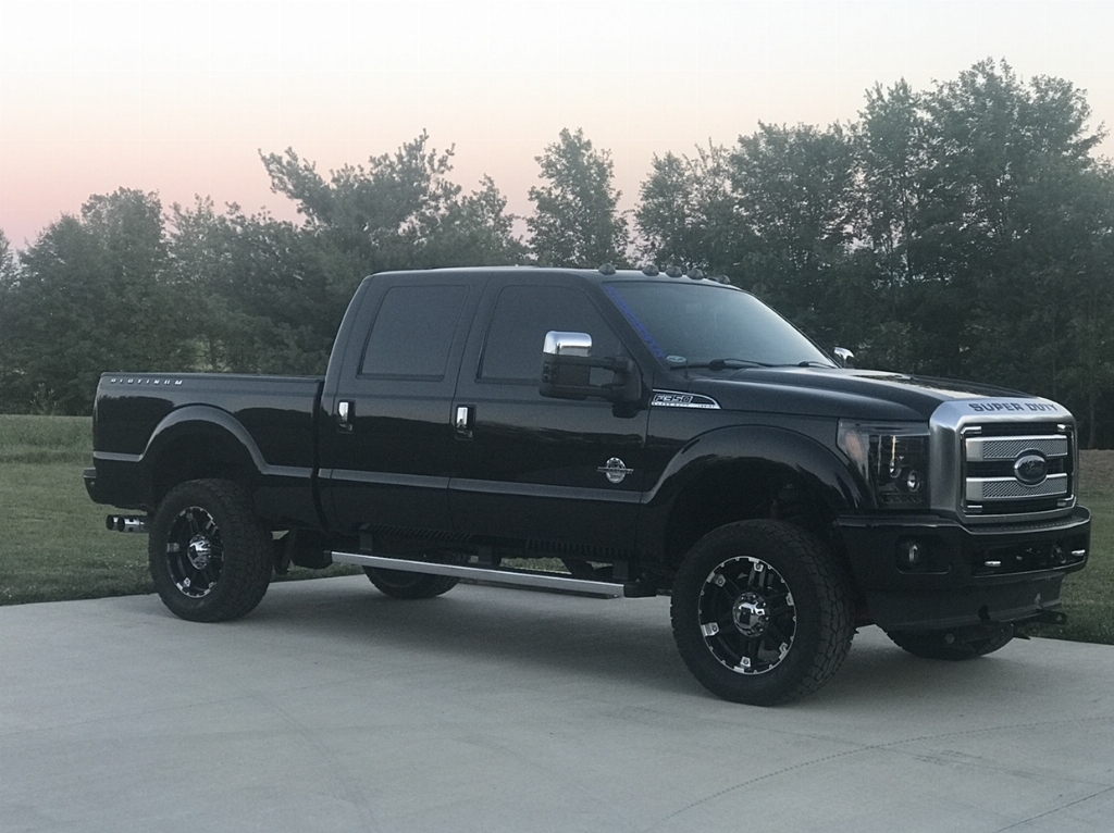

2.5 carli springs and 35s. would like to throw on a cool bumper but too scared it will look silly with plow bracket.

Quote:
Snow plow on a Platinum!
Nice truck.

Quote:
Nice truck.
couldnt pass it up. just had to take it off father in laws truck and install on mine. beats my open cab tractor.

That black platinum is also a 350 so it has 1.5" more block in the rear. When you do a 2.5" level on a 250 most add a 350 block to the rear.
