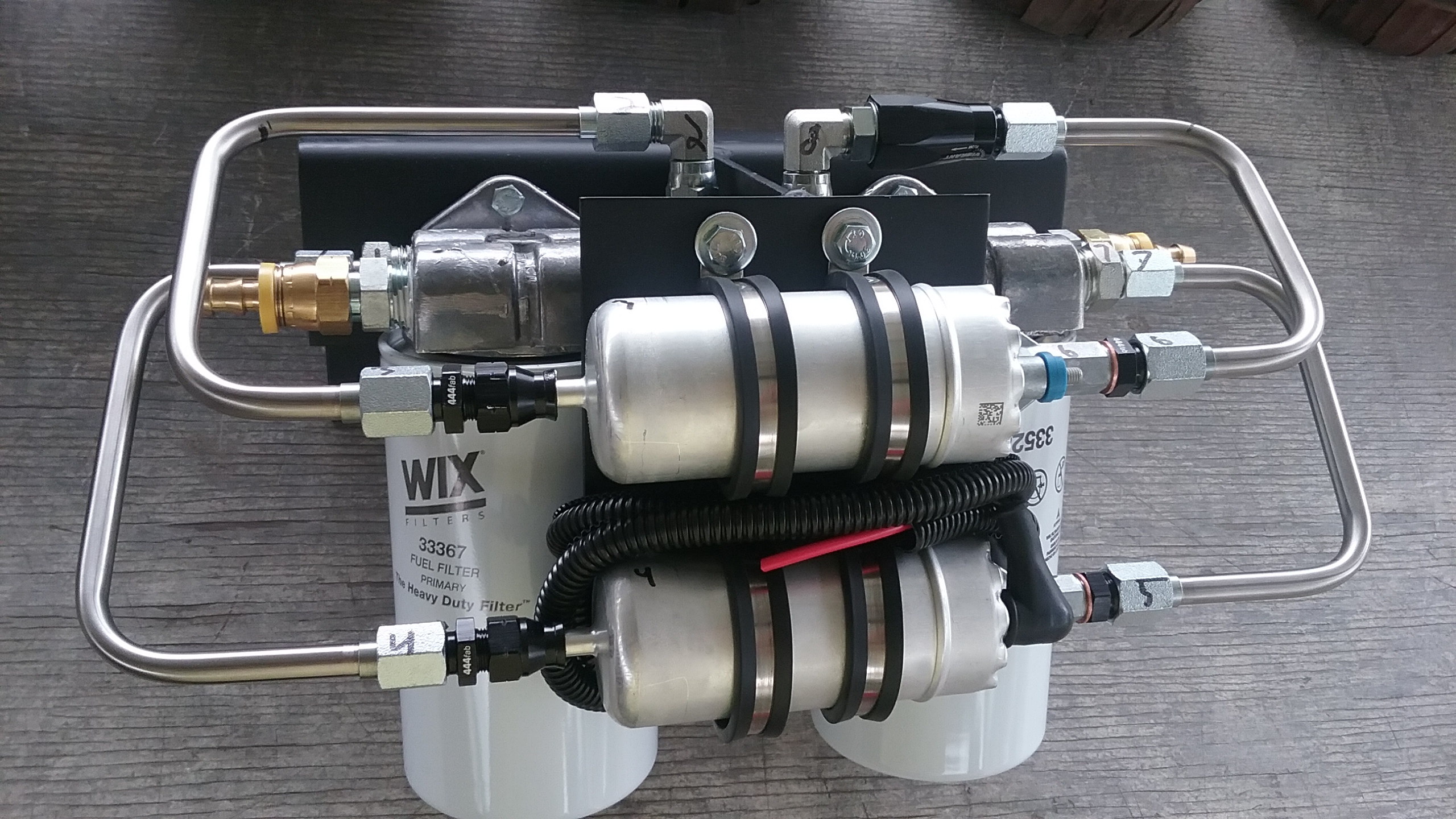

ok I went dual fuel Bosch pumps setup regulated return from 444fab . here's the pump setup in pics . I'm running stock injectors as of now but will be upgrading to 238/80 in the next couple months when I get the funds saved . starting with fuel since the stock pump started leaking .
so the questions
can I hook up the secondary pump to a pressure switch on the regulated return. if so what pressure should I make the secondary pump kick on . and in pics u can see the one way check valve is installed on the top pump . should it be the primary or secondary pump.

this is my second kit from 444fab also . other kit was a single Bosch setup but a may add a secondary pump to that kit also .

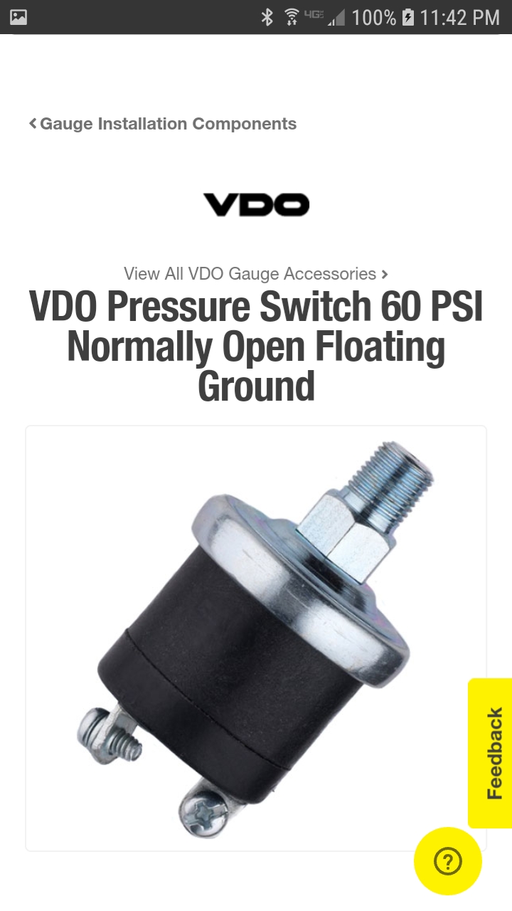

Anyone got and thoughts on the pressure the switch would need to kick on the pump

Any thoughts on this it would be open meaning turn the pump on tell it gets 60 or above the way I read . If I set my pressure at 65 which I have on my other truck would this be the pressure at I would the second pump on or off . Not sure this is fuel rated though.

Anyone see on that will work on this page starting at page 17 . I figure one around 60 psi that's adjustable.

So here's me thoughts I can see a possible problem with the fuel pressure activation. It could cause the pump to cycle on and off fast right if it picks the pressure up fast . Then it would kick off then pressure could drop fast then cause it to kick back on . Could this this cause a problem?
So I'm lean more to the boost activation using the autometer elite gauge as the in cab adjustabilit would be great plus running it through a on off on toggle switch so I could run the pump from the gauge or have completely off or run through keyed power as a manual on if I just needed even in a primary pump failure. Thoughts ?

Well here it is all mounted up . Got to wire the boost gauge and switch and install the hydra for the selector to work . 20190729_133745.jpg
