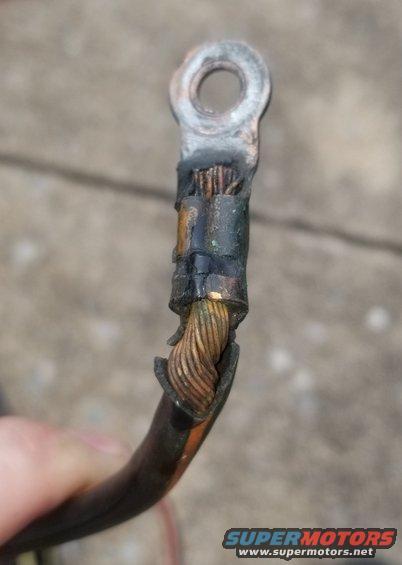

This one from the alternator has been bothering me since I got the truck. The green rot goes back several inches.
While I've been collecting pigtails, wire, and fresh bits & pieces I was doing a lot of searching for diagrams, pin-outs, and what not. Everywhere I've read has said this main wire from the alt cannot be replaced.
Turns out that is not at all true. Since I was replacing worn out GPCM connectors, I was going to have to deal with it anyway.
At least on my truck this is the only place in the wiring harness where this cable ties into anything. While I'm sure GPR truck are different, I can't imagine it being more complicated.
Once it was de-pinned from the connectors, it was completely free from the harness. Trading it for a run of 2ga and a mega fuse to replace the fuse links, and this was the easiest part. Still got ICP, IPR, & Valve cover connectors to do.

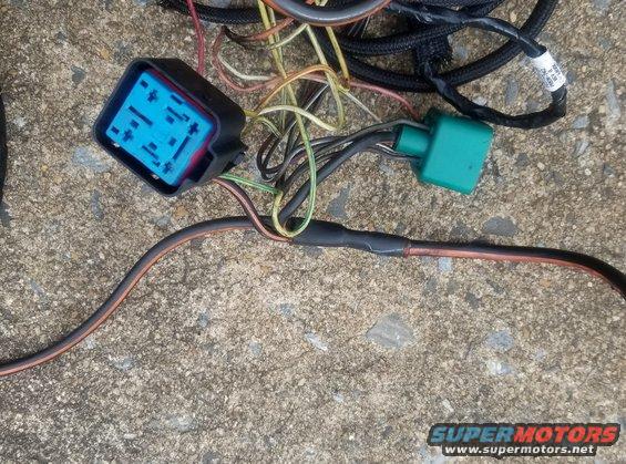

Yeah so it's decided to rain all day. Progress isn't what I had hoped for, but Managed to get a lot done anyway. Pretty much all that's left is ICP & IPR pigtails, then organizing and wrapping things up. Probably Monday before I get to it again.
I did plug everything back in an take it for a drive to make sure I hadn't messed anything up. Luckily no smoke, sparks, fires, or check engine light.
I must insist on a measure of leniency for the following images. Weather and needing this running for tomorrow, everything is temporary. Better details and pics will come....
Huge mess right now . This is a completely unwrapped wiring harness with everything separated. Don't worry, it's not staying like this.
This is the good stuff though,

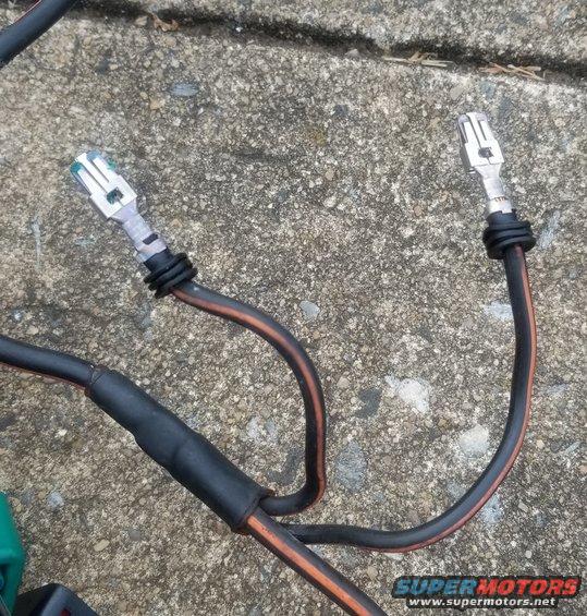

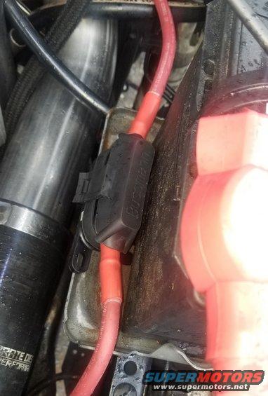

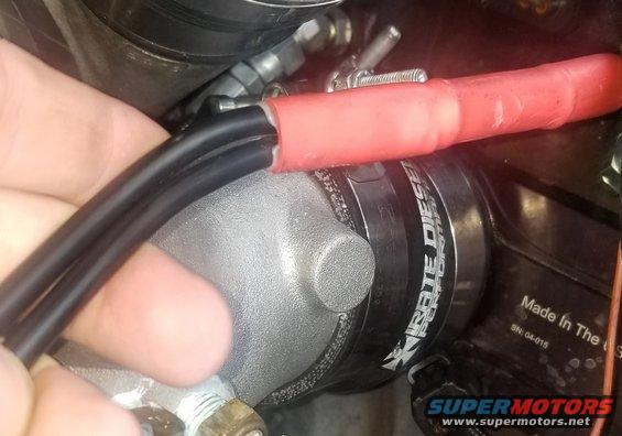

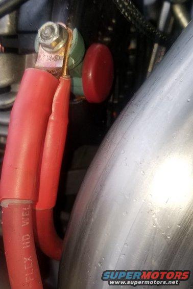

2ga cable to alternator, 2ga buttsplice with the gpcm connection crammed in and chock full of solder. Wrapped in adhesive heat shrink tubing. I'm still somewhat amazed the number of discussions I've read stating this cannot be done. Surely I can't be the first 7.3 guy to go there.
2ga cable runs along above the valve cover to the alt, then back down the the driver side battery.
protected by 250amp mega fuse. Although not originally planned this way, I do like the fuse location. Might make this permanent.
Over on the passenger side, I just ran the wire from the solenoid to the battery terminal over there.
AIH relay, bowl heater, water in fuel, and a slew of other things no longer on my truck got de pinned from the 42 pin connector. I never liked having the wires flopping around for nothing.
Over all this is not hard to do. Just very time consuming doing one wire at a time, checking continuity & resistance, and making sure nothing get tangled or spliced to the wrong thing.
A good heat gun, soldering iron, smallish butane or propane torch, and top shelf wire strippers are about all of whats needed for tooling.
More to come.

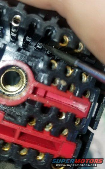

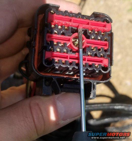

The 42 pin connector. It's super easy to work with.
Use a little screw driver to lift out the red retainers. Make sure to re-install them when done. They prevent the terminals from backing out.
Once the retainer is out. Carefully pry the tab away from the connection of choice. It will easily slide out the back. This was a hard pic to take.

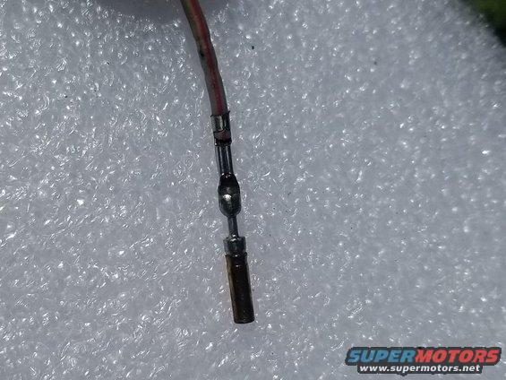

Here's the terminal shot. Ford Wedgelock Terminals E7EB-14487-AA for the engine side of the 42 pin, E7EB-14461-BA for the chassis side. If you have damage to your wires and need to replace a whole run from the connector. These are a crimp-on affair.

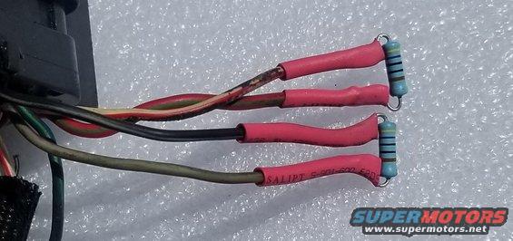

Code eliminators, shortened and tucked away.
These are the 1watt 470 Ohm resistors for the something or nuther I removed years ago. I think it was the EBPV and the waste gate controller... I think.
Used some of the heatshrink to seal them. This will keep corrosion out and make for a proper headache should I need to replace them.

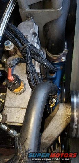

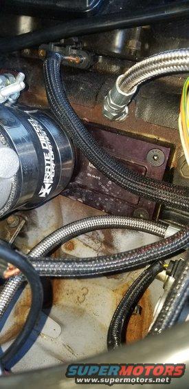

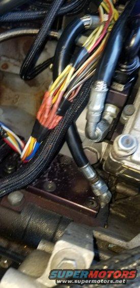

Front of engine stuff,
CPS,EBP, coolant temp, oil pressure all consolidated into their own bundle and branched out from the 42 pin along the driver-side and across the front as seen here.
Still working on a good shot of the valley. Not a photographer.
It's still a mess with the bulk of the glow plug and injector wires unwrapped.
This is where I'm liking it. Forward up and over where the bowl used to be. The connections to the valve cover gaskets lay down nicely going forward, and out of the way.
