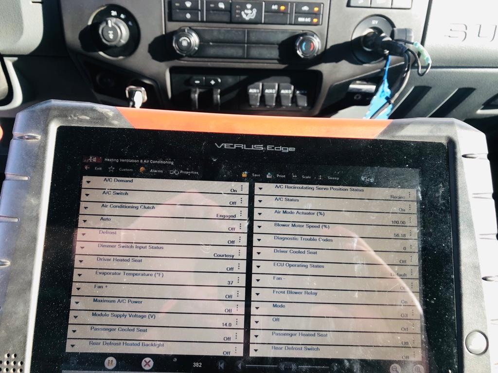

Hereís pics of the scanner results with engine on and max ac engaged.
Granted all pids are not monitored being an xl without all options

Evap core temp is 35 ish at idle and the blower blows as it should.
