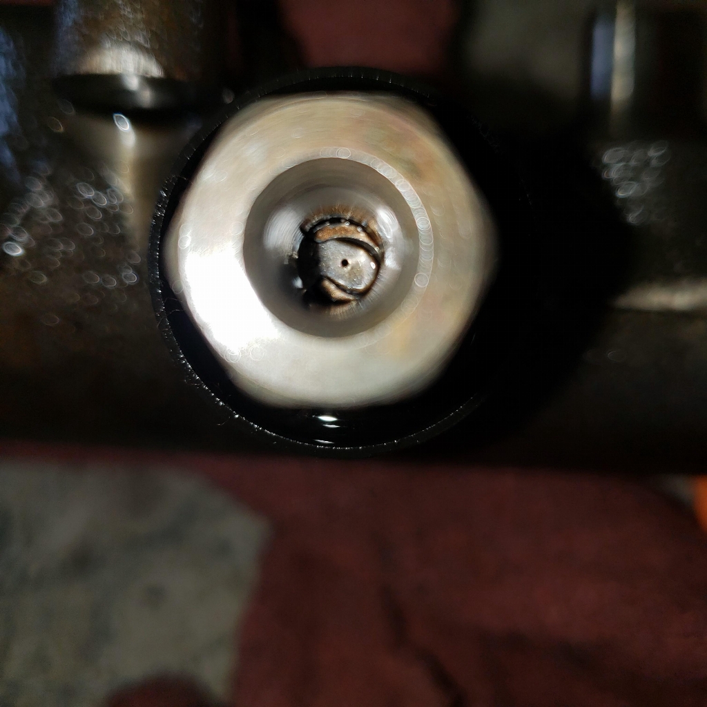

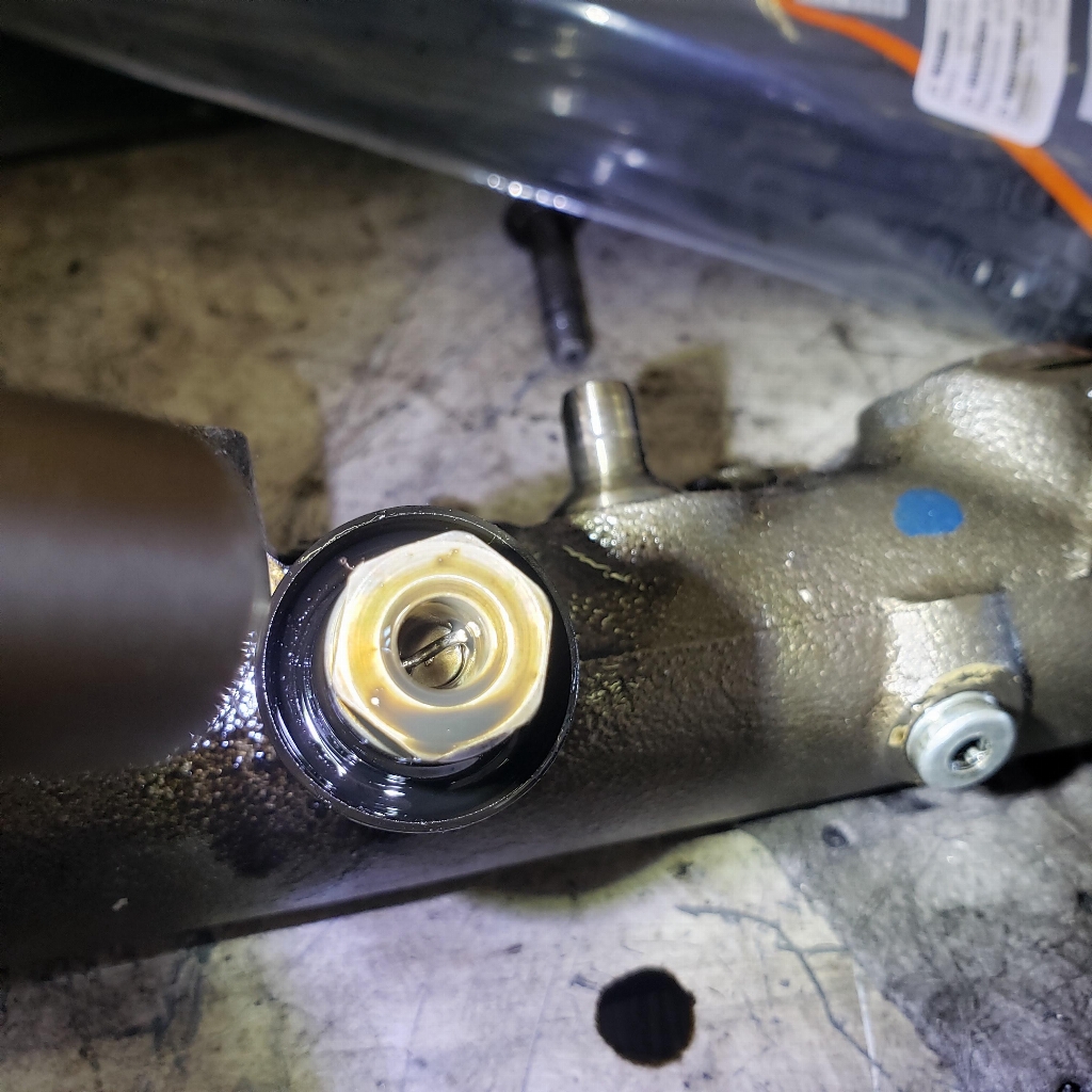

Now I'm swapping ficms, measuring fuel psi, compression is good at 510 psi, checking for airetion, etc etc... Nothing. All good. I'm up to 10 hrs now losing my ass on this... Gotta be something wrong with the rail... Nips were tight, it's a log rail nothing special... Man.. Gotta be something up with the rail.. Watched it run with valve cover off for 30 mins.. All look good...

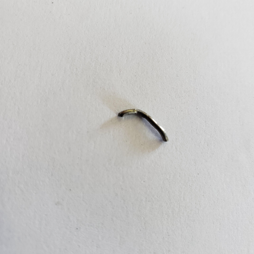

Remove rail to inspect the snubber...
Not sure what the hell it is. But had to come from hpop right? I'll grab better pic Monday. It's been a **** of a week

Weve seen **** like that come out of the later standpipes. Havent taken apart an early one, but theres gotta be a check valve in it right? The legs of the check valve would sometimes break on the late stand pipes and send **** through injectors.

Please post that pic when you get it out!! And tell us if it is magnetic or not.

Truck runs great. Lol. So it was. Causing an ICP issue affecting front and rear cylinders

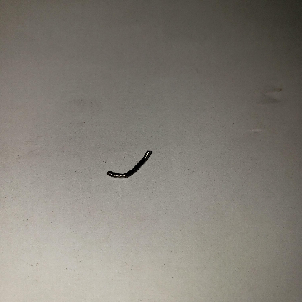

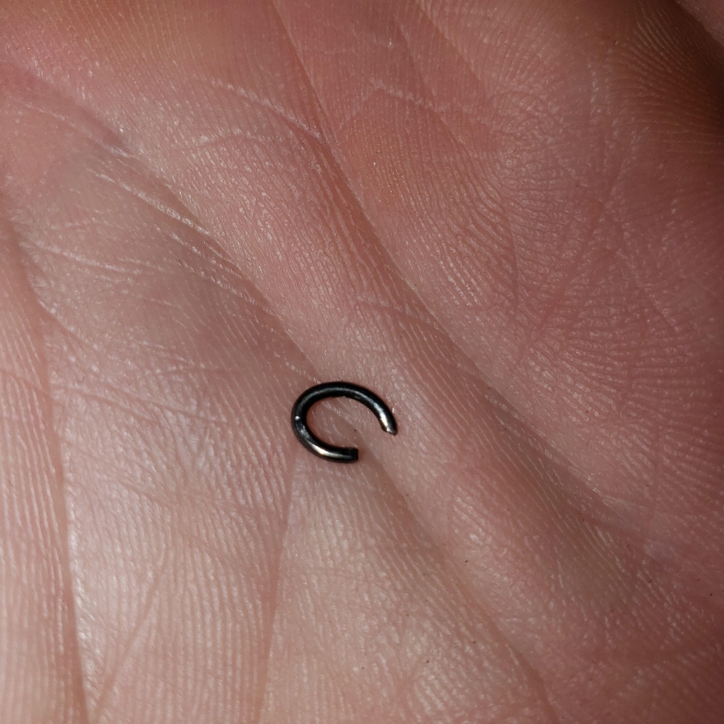

DIFFERENT TRUCK. SAME THING. Did all 8 and when hot #3 was dead. This piece of magnetic metal is very very weak and does not bend at all, it snaps immediately with any pressure applied with needle nose. What is this?

Took apart a hpop yesterday and nothing in there looks like this
