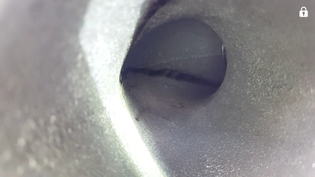

My 38r eventually started leaking but on the compressor side behind the wheel. I was pushing the same coupling off fairly often and figured there was a problem. Found this stream of oil in the spider.

Pull that first boot off of the spider/ discharge of the turbo and run the truck. I had a steady stream of oil.
