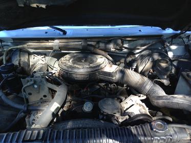

A friend of mine just bought a 1993 F250, it supposed to be a turbo truck. They don't live close but I got an under hood shot and it has what looks like the IDI non-turbo air cleaner?? I'll post the pic later but it doesn't look right. Anybody got any underhood shots from a 1993 w/ a factory turbo??

doesnt look like a turbo truck to me...

Definantly not turbo.

Thats what I said...they proceeded to tell me I didn't know what I was talking about. Hence my post here....
