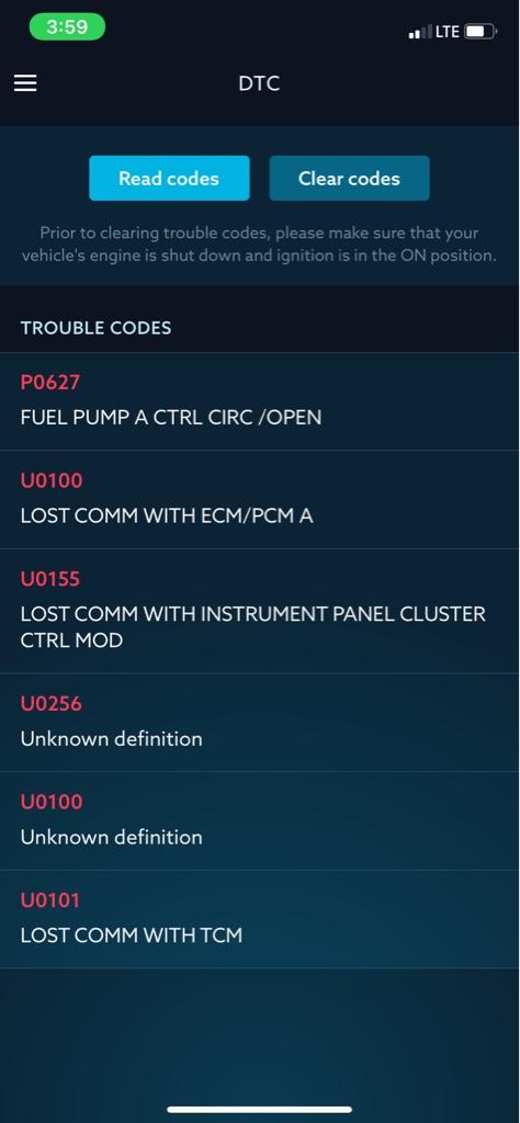

Loaded a new tune and now truck won’t start. Starter sounds but never fired like there’s no fuel. All fuses are good. Any help?

Check the inertia switch inside the passenger door.

If what sootie says doesn’t work then Reload your last tune and see if it will fire.

That’s for all the help. I was able to get it going. Let’s just say I’m an idiot

No. When i was installing the tune i checked to see if there was a fuse for trailer back up lights. I moved a fuse thinking it was from an extra space only to realize it was the 10a fuse for the fuel pump
