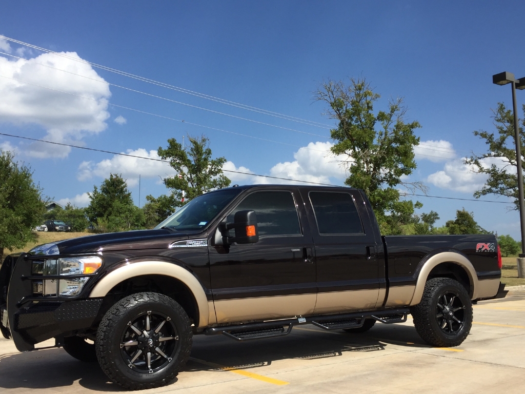

I currently have 285/65-20 (basically 35X11.50) BFG A/T's on 20X9 Fuels with +20 offset and they are fine. I had to trim a tiny bit out of the bottom center of the right fender liner as I got tired of hearing in rub when I turned right and hit a decent bump. I'm thinking of switching over to some 20X10 Forces with -25 offset on the same tire. Do you think they will work without having to trim the actual fenders? I don't mind trimming more of the inner fender liner, but I would prefer to not trim the actual fenders. Truck is stock as far as suspension goes. Here is a pic as sits now.
