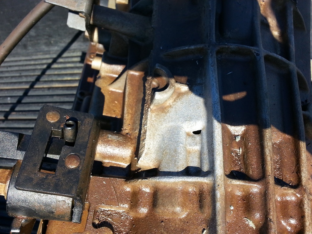

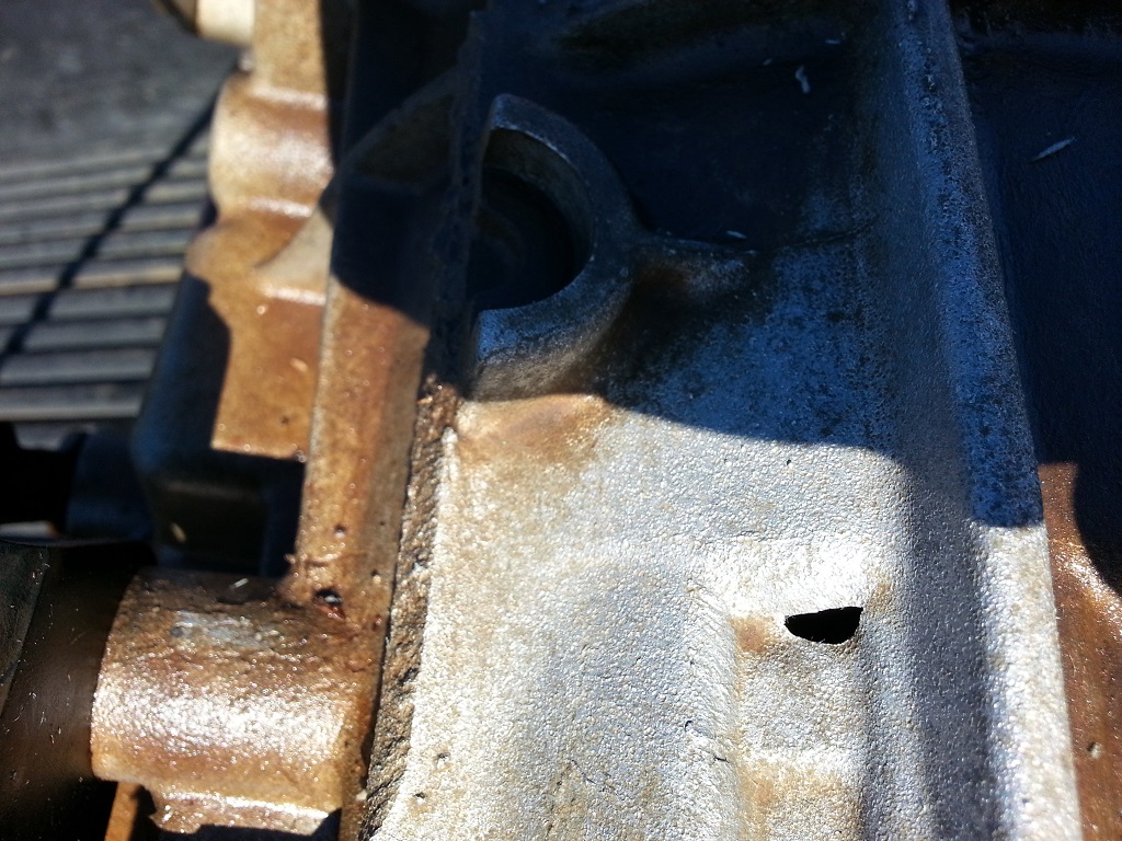

Anyone ever seen something like this? Dad had been having a transmission leak and it was finally tracked down to this hole in the top of the housing. Best we can figure it was just a bad spot in the casting that flaked out finally. This tranny has a little over 200k on it, so can't really complain. It's been tig welded up and is headed back in now. Just wondering if anyone else ever came across something like this.

What year is the trans? The 2005 model year had a problem with the snap ring coming out of the reverse clutch and leaving the trans by going through the case.
ParkerFly
258
McMinnville, TN
Same thing happened to my fathers old 05. Same placement and same size hole. Right over 100k miles
Did you figure out anything that caused it? Did you weld it up like we did or just replace it?
No reverse could be a symptom. It is possible that enough of the ring stays in place to hold the clutch together.
Reverse is still there right now and the transmission seems to be working fine. I guess we'll have to keep an eye on it and see what happens.

Reverse clutch snap ring punched a hole. As soon as the incident happened the trans was replaced. Couldn't chance it with a truck that pulled a 40ft 5th wheel.
ParkerFly
258
McMinnville, TN
Well something ended up letting go in the trans. It worked good for a month after the hole was repaired but sitting at a red light the other day it suddenly lost everything. No forward or reverse. New Ford reman is going in now.
