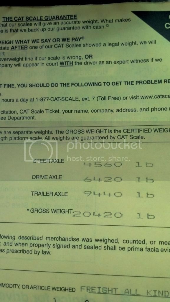

[QUOTE="gnxtc2, post: 1185804, member: 1414"] Here is a guide: [url]http://www.thedieselstop.com/faq/9497faq/geninfo/95ttg/16.php3[/url] I've towed 22k with 3.55s but I have the HP to do it. The more HP you have, the less gear you need. I would also check pin weight vs the rear tire capacity. I run 285s "E" rated tire which have a capacity of 3750ea x 2 = 7500lbs. If I had the stock 235s which are rated at 3042, I would have been over. [ATTACH=full]149859[/ATTACH] And get yourself some airbags for the rear. Billy T. [email]gnxtc2@aol.com[/email] [/QUOTE]
