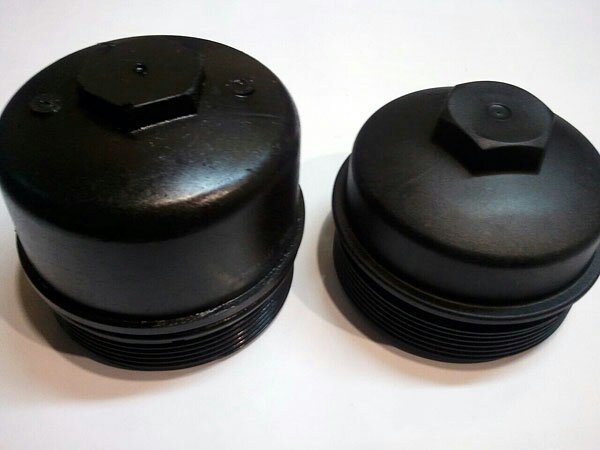

Have you changed your oil lately? I am thinking that the oil filter housing is draining but the HPOP has enough oil in the sump to get you the initial start.
scorpio64
Feb 28, 2014
5
Southwest MS
Did you use a Motorcraft filter? There is a spring loaded drain in the bottom of the oil filter housing. If it is leaking it will drain the housing overnight and cause hard start problems. Some aftermarket filters and caps are not the correct length to make the drain seal off correctly. You could also have other issues. But I would look there first.
scorpio64
Feb 28, 2014
5
Southwest MS
The symptoms you have describe a problem with oil in the oil filter housing and or the High Pressure side draining back to the pan. Before you crank the truck in the morning remove the oil filter. Look for oil running off the filter, if it is dry the problem is probably in the drain for the oil filter housing.
jdeeg4276
Sep 4, 2012
309
Vancouver wa
Notice the difference in cap sizes. Make sure you have the smaller size cap with the moter uploadfromtaptalk1394283793941.jpg craft/international v365 filter
