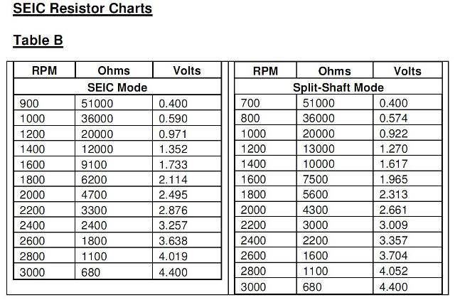

Here is what I did.
potentiometer is in the upper left.

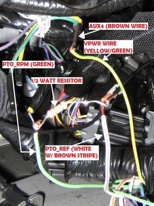

So... power supply, to upfitter, to pto and a resistor in there somewhere? Would that work? No remote start for now. Im not the greatest with trying to figure out wiring.

I did it a while back with a 20k resistor. Works good. I'll check which wires I tied into later.

Does this only work when the aux switch is on AND the parking brake set?
live life full throttle
Yes that's how mine works. Only thing that sucks is it won't work with the factory remote start unless you put in your own switch with some kind of power source.
Ok. Just makin sure. I was about to say, wtf did I do now? Lol..
anyone know how to make it work without having to press the parking brake?

Gonna do it on mine with a potentiometer. Will advise about Park Brake if some else doesn't first.
