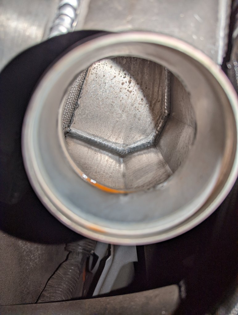

I've got the Absolute Performance Intercooler on my truck.
Been on there about 55,000mi. Truck has always used a little coolant from the secondary, but I passed that off to a slight leak from the hose connection above the passenger head. I've chased it several times, but never been able to totally eliminate it.
With the rash of AP IC's that are on FB leaking I figured I'd better check mine.
Sure enough, it's leaking. Insides of the pipes are wet too.
I've used the better part of a gallon of coolant over the last 6 years leading me to believe that it's not a severe leak.
Question 1: Is it likely I've damaged the engine now?
Question 2: I never really noticed a drop in EGT's, is an aftermarket IC really worth it or should I go back to stock?
Question 3: If an aftermarket is really helpful, which one should I choose?
TIA as always.

Doubt you’ve hurt the motor at all. Not sure on the actual benefit from an aftermarket intercooler on the 6.7s, as it’s water to air, so it’s only going to get as cool as the water. On a mostly stock truck stock is probably fine, if you’re pushing higher boost levels, like much higher, a no limit is probably the go to.
I’ve seen plenty of factory coolers leak, and also seen plenty of aftermarket ones leak as well. Think the only benefit from the aftermarket is they are mad or higher quality aluminum, and shouldn’t leak as easy as a factory one at higher boost levels.

Stock ones are known to leak. Some bad enough to throw codes.
When I have the need It will be a No Limit IC. Costs a pretty penny, but it should be worth it.
With the little bit of coolant you have used I dought it could hurt the engine at all.

Take an oil sample and see if there is coolant present. Or change it. I'd be curious and I'm an oil sampler so I'd love to know

The motor won't be hurt. No reason for an aftermarket I/C anyway....go back to stock.
