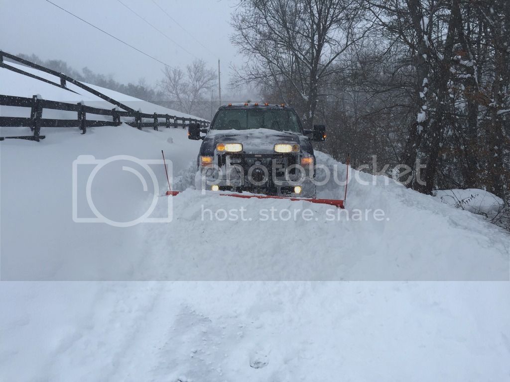

No issues with No Limit and snow here. Top of the fence is 51"
i've never heard of any issues, from snow, dirt, or moisture .. ever. and thats with thousands of them sold.
