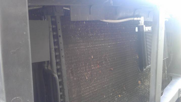

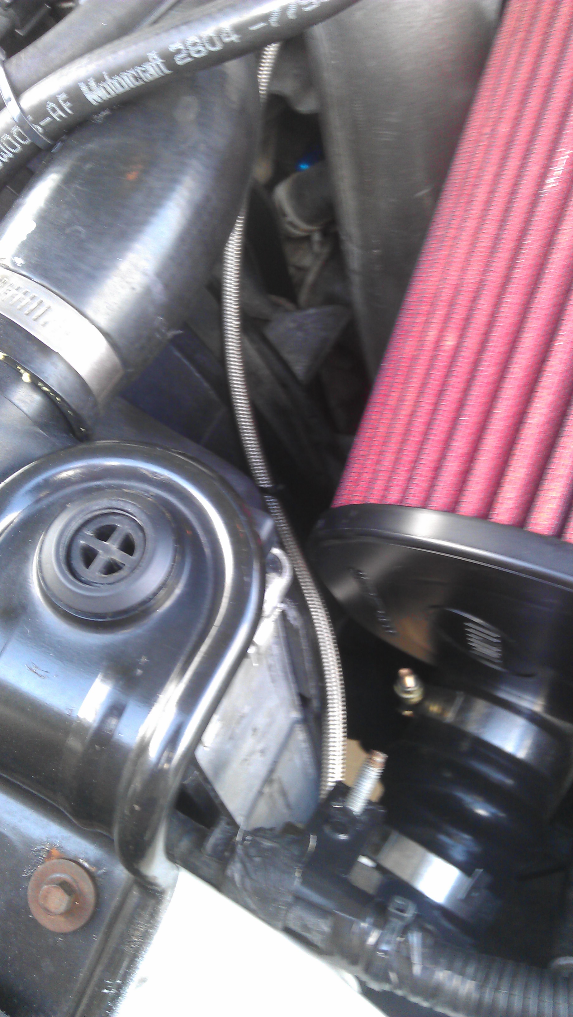

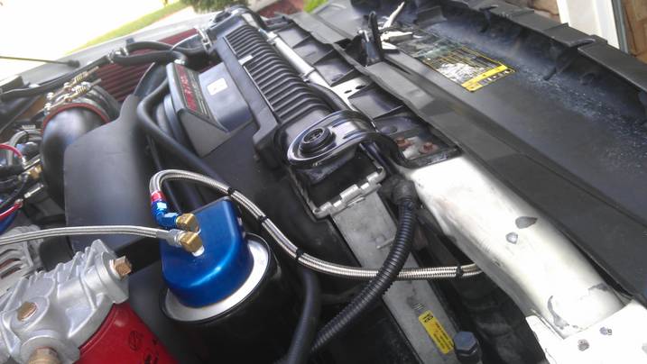

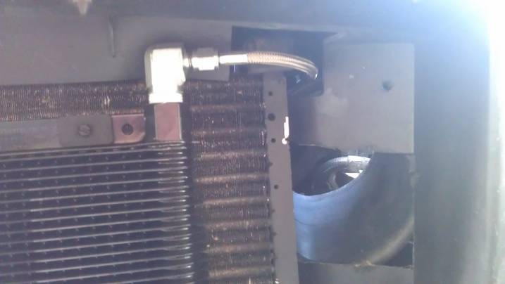

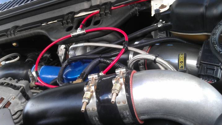

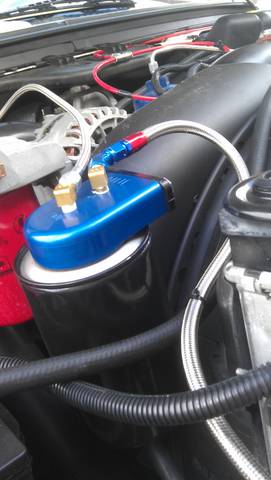

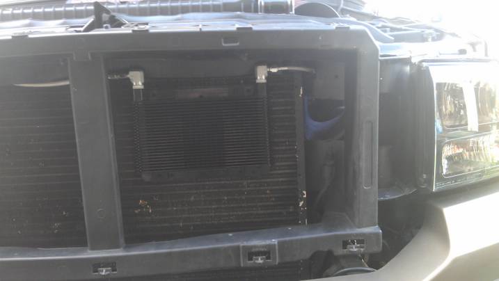

[QUOTE="fulton327, post: 349269, member: 6949"] So after adding a new turbo and a bigger tune I noticed my eot where starting to get pretty high. I had about a 30 + deg split from eot and ect. So I already had a NUC bypass filter and decided to add a B & M oil cooler in line with my filter. The oil cooler I used is a B&M 70266 rated to 20,500 btu. I kept it small so I wouldnt block alot of airflow to the radiator, intercool and etc. I was able to lower my eot by about 20-25 deg and it was all off the self parts from summit in all just over 120 bucks for everything. Ill put up a couple pics let me know what you guys thing like it, love it, or hate it. Oh and if you have a sharp I you will notice the red and blue fitting at the bypass filter its because I broke the 90 deg silver one I had but lucky I had some spare fittings around. But I already ordered a new one so it would all match up. [/QUOTE]
