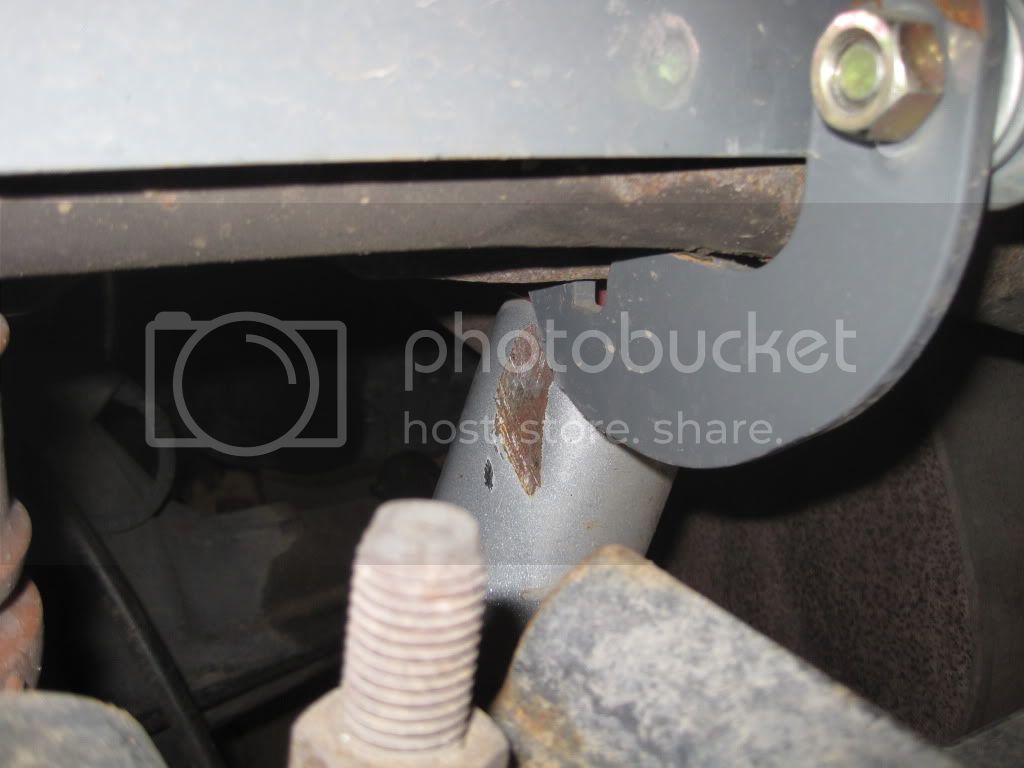

[QUOTE="15Platinum67, post: 1482766, member: 15609"] I had the same issue when removing rear passager shock. I emailed B&W about the issue and they are aware of it and the engineering department is the the process of a redesign on the hitch cross member. I removed the cross member and plasma cut a notch in it for future shock removal. This is their response. Thank you for your inquiry. I apologize for any inconvenience you incurred with our hitch. We have found that with our hitch installed on the new Super Duty trucks it does have to be slightly disassembled to remove the shock. I will make sure that the information you have provided is sent to our head of engineering immediately. We greatly appreciate your continued support of our products and will make sure this issue is promptly addressed. If there is anything I can assist you with in the future, please let me know. [/QUOTE]
