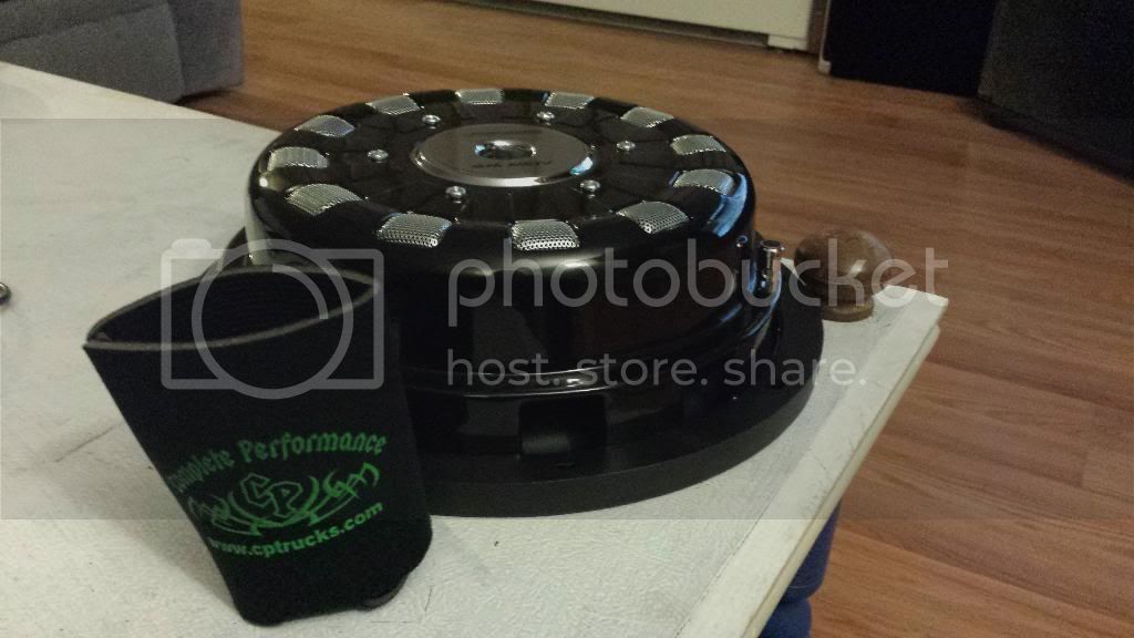

Be a little while before I get a box together and put some power and music to this sub but finally got it in hand.
Stereo Integrity BM MKiV 12" shallow sub

Gonna be with my sundown 1500d at 2ohm so 800w sub is rated for 450w rms. But I will keep the gain low till it breaks in and then turn it up and see how the sub likes the extra power.
Plan is to toss it in my current center console box at 0.5ft^3 and then build a box for under the rear seat.

The SI sub wants to see 0.5ft^3 where the JL calls for 0.8ft^3. So you could fit 2 of the SI subs in a box slightly bigger than the JL's optimal box. For what the JL wants for a pair you could squeeze in 3 of the SI subs.
