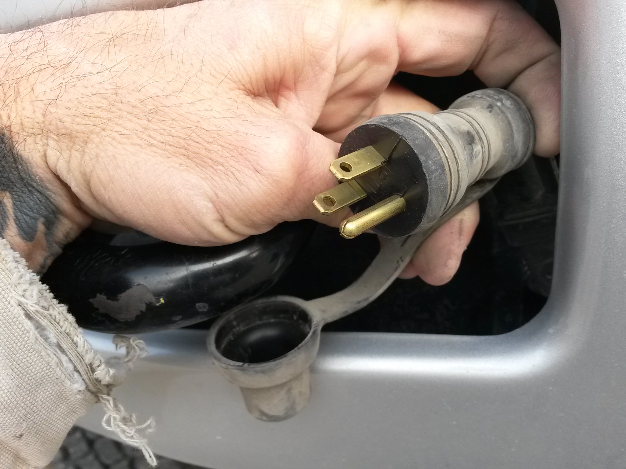

Could someone post a pic of what this looks like? Is it just a basic looking plug? Like the end of an extension cord? I don't think mine came with the plug.

All the plugs I've seen on the 6.0s look more round then the 7.3s and most replacements. Just look on the frame near the bumper on the passenger side it'll probably be the only dead end wire if it's their.

I guess I got lucky..is this the plug?

Cool!.. just wanted to make sure before I go plugging an electrical cord up to something I didn't know what it was!
