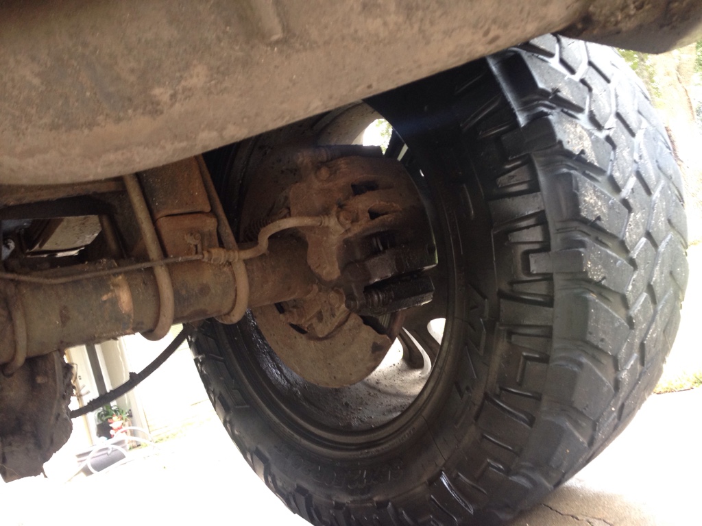

ImageUploadedByTapatalk1421093986.557826.jpgfound it... No fluid

What do you think is causing it? I know I need pads. But what about the fluid leak?

When the pads get down to nothing the cylinders in the calipers blow out causing the seals to bust and fluid to leak out.
