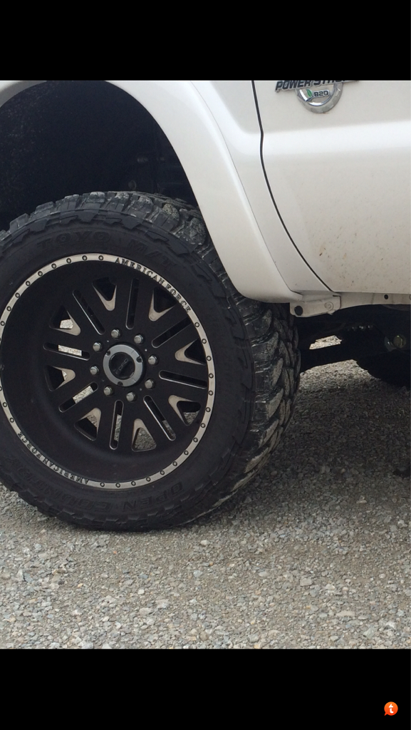

The truck is also rocking 22x10 American Force Delta's w/ 35x12.50/22 Toyo Open Country MT's

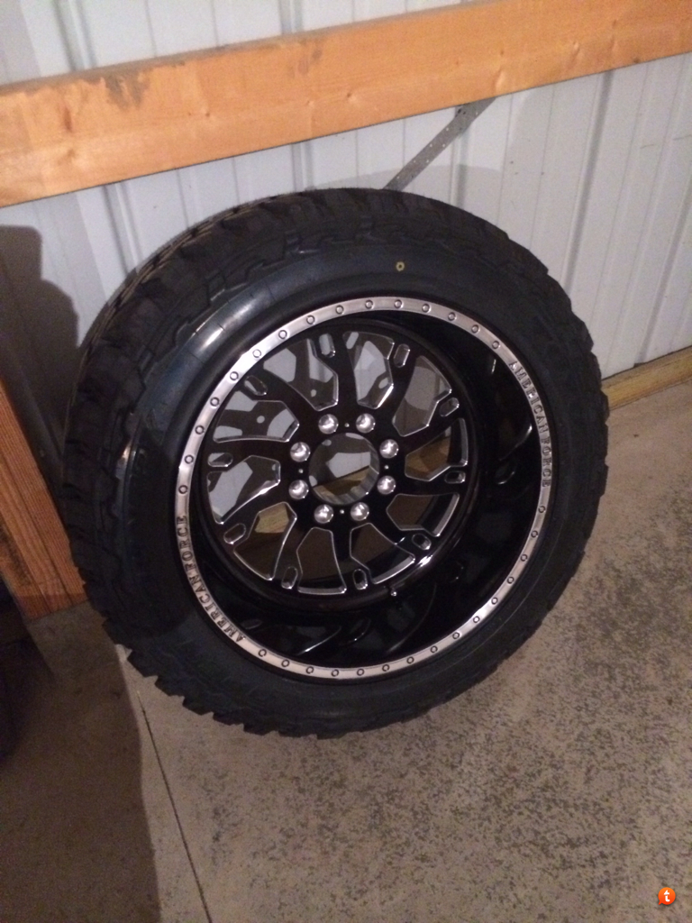

Sean & Tyler @ Street Diesel Performance hooked me up on a custom set of 22x12" AF Raptors with 35x12.50 Toyo MTs, very excited to see them on the truck..
