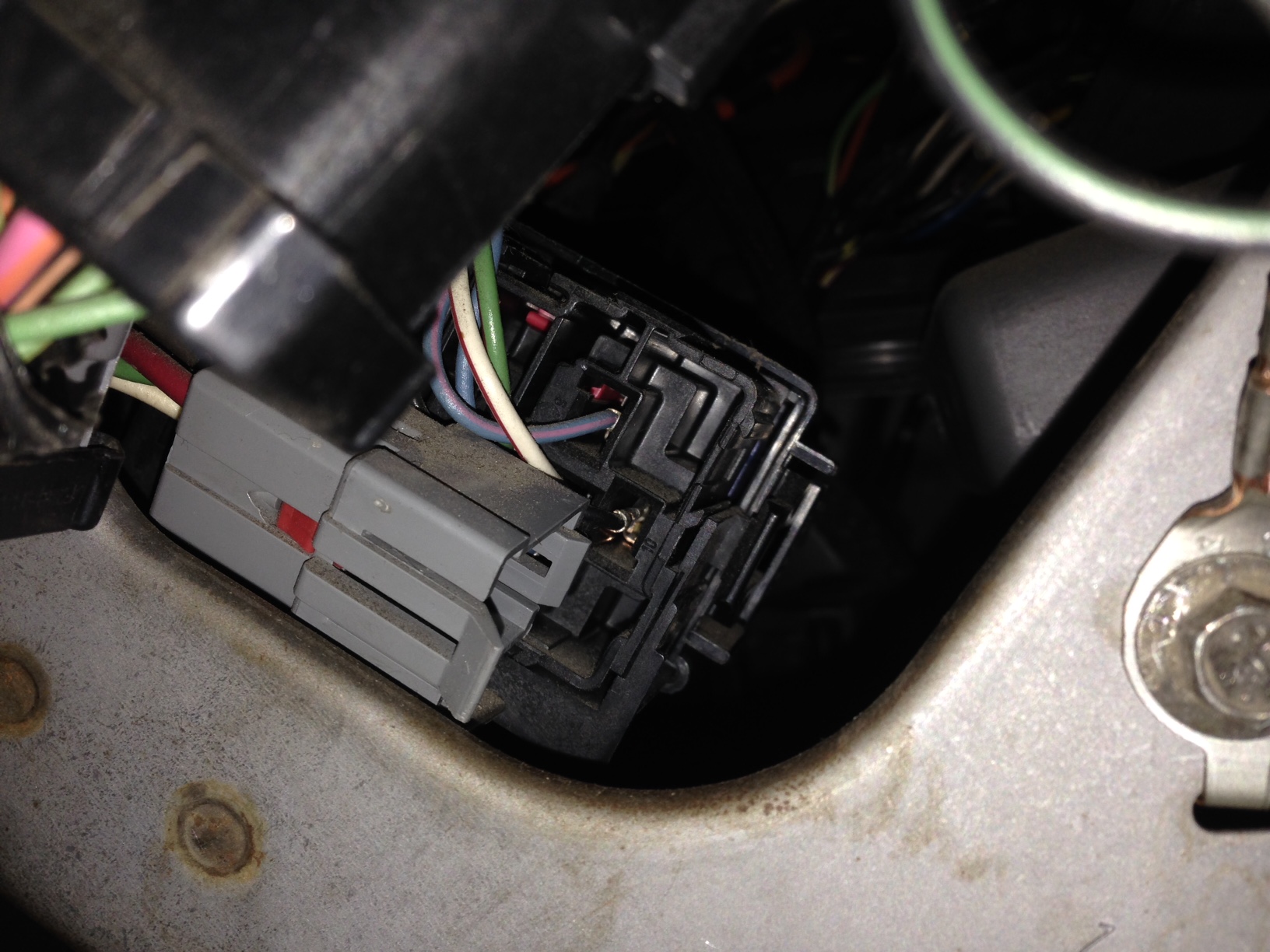

On my '02 F350........there is some kind of module located right beside the plug-in for the brake controller....it has an electrical connector on it.
It will intermittently make a loud buzzing noise that stops instantly when the brake pedal is depressed........any idea what this is called.......... and what the fix is?

OK here is the best picture I could get........(click pic to enlarge)
the suspect module is the black one located adjacent to the gray brake control connector.....(behind it in the pic)

Yep. Check the hazard switch. They sometimes fail and try engaging, then do exactly as you described.

Thanks.......I was using the hazards to help troubleshoot.......again it would buzz continually/intermittently......... as long as the switch was on.......touching the brake stopped it......engaging the hazards made it work properly as well........
Popped the cover off and pulled the relay while it was still buzzing........replaced it and it seems OK :redspotdance: .......this is my flat bed dump truck so I don't drive it as a DD........we shall see.....:shrug:
