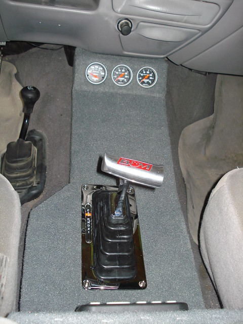

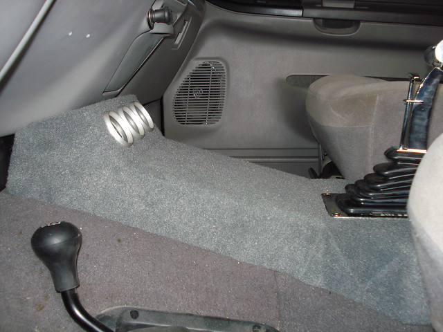

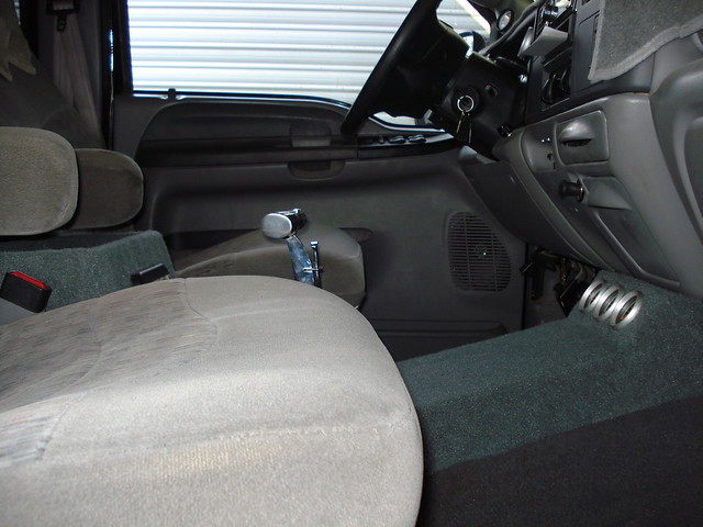

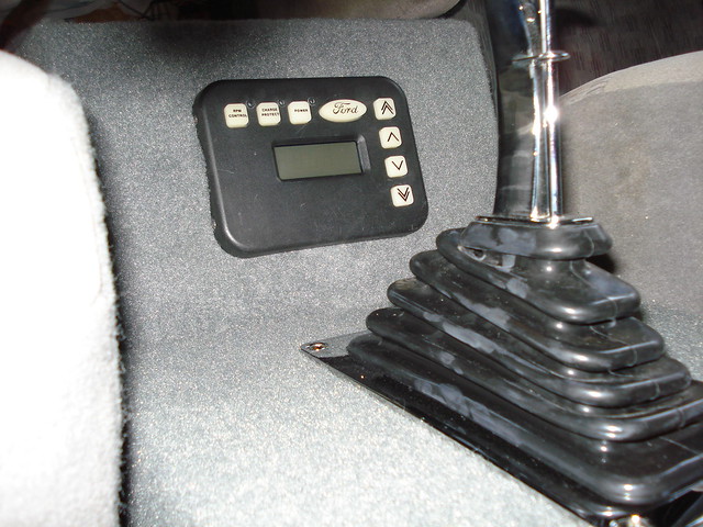

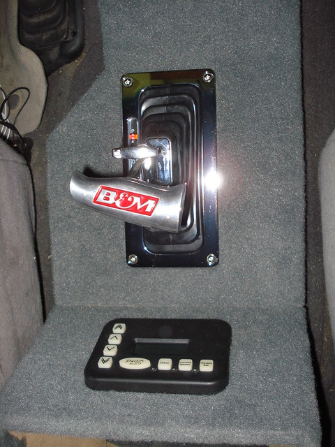

[QUOTE="uncool, post: 327911, member: 1802"] Don't remember what I did for the linkage. It was a combination of things. I used the factory arm from the 4R100, and a standard carb snap over ball adaptor to go to that. I think I had to make a threaded adaptor to fit in the snap over and tapped to fit them B&M 10-32 cable end. I found something in my junk drawer to hold the cable to the tranny case. The 4R100 has a long detent between 1st and 2nd, So the shifter works perfectly from park to 2nd. I was never able to get the shifter to put the tranny in low, If I want low to stay locked in I just go to manual mode on the PCS and hold it there. I'll try and get a picture of the linkage in a few days, working 6 15's for the next few weeks. Marc [/QUOTE]
