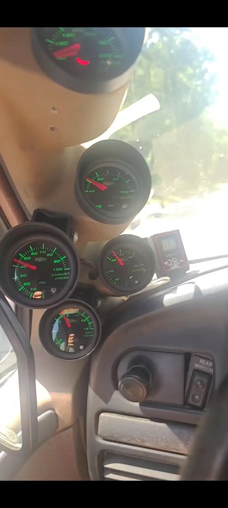

I've searched for leaks everywhere! That was my initial though but there are none to be found. I haven't yet tried a bigger housing on the s369, I have a 1.10ar housing for it but was reluctant to swap it over until I figure out what the root cause was for the lagginess. I didn't want to make an already bad situation worse confusing myself in the process. I grabbed a screenshot of one of the pulls I made and at 50psi total the gt55 is making 35psi, hopefully it'll let me attach it cause it also shows my ebp gauge. For what it's worth the ebp was only 45psi at 50psi of boost so at least it's better than 1:1. The top gauge is overall boost, the one next to the hydra is the first stage (gt55), and the top gauge in the left is ebp

With your boost numbers, it shows the 369 is not spooling. The gt55 is doing all the boost but a few pounds of it. Something is keeping the s369 from spooling.
Even with a 1.10 housing the s369 should spool way before 2500.
Basically the gt55 is what's spooling at 2500rpm. That's why all the lag. The s369 is not spooling. Get that took.care of and you should have a fast spooling rig.

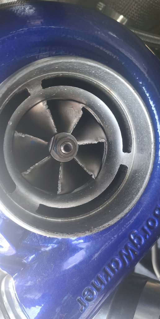

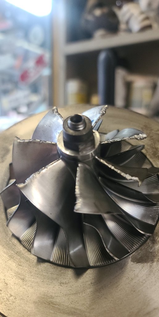

Well I dug a little deeper and found a pretty serious issue, something has made its way into the compressor wheel of the 369 so I'm just gonna assume that's part of my problem
That’ll do it. Check the 55 as well, if something came apart in it it would do that. Also check the turbine wheel of the 69, see if it melted or something too. We’re the bearings bad, ie excessive play in it? And did it get the compressor cover?

I checked the 55, it's fine. Also pulled the turbine housing and all is good on the hot side, the compressor cover has a few spots on it but they're all around the surge ring and look to be just cosmetic. The area where the compressor rides amazing looks untouched, the bearings are fine as well no shaft play at all. I had a separate shop weld a v band to the compressor housing of the 55 and even though I thought I cleaned it very well prior to install I must have missed something that didn't agree with the s369. Also double checked the wg dump and it looks as if it actually has been opening, it currently has 26lbs of spring pressure in it and is fed full boost to the dome so I'm not exactly sure how that's happening.
