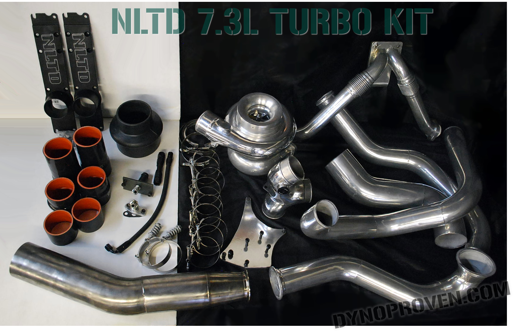

With 250/200s ide definately go with a t4 mount. The d66 and 38r obviously still use stock style pedistals. Which leaves NO room to grow. And unless you find a deal on used turbos, they are still gonna be at least $1k+. Spend the little axtra coin and get a t4 mount kit with bellowed up pipes. Then you have ALOT of turbo possibilities.
