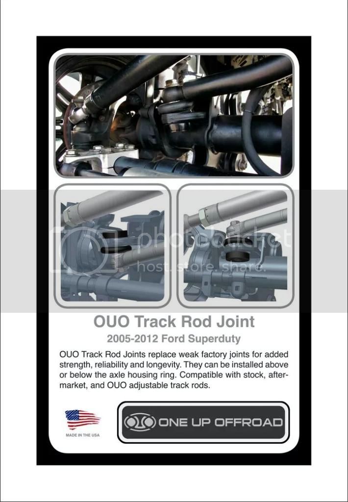

I'm kind of new to this and I don't even know what the track rod joint is. Is it the joint on the passenger side that holds the track bar in place?
Layson
1,638
This is what it looks like. Probably should get under it. Have someone turn the steering wheel and watch everything. I wouldn't just change it out just for the hell of it until you get it figured out.

The trac bar itself does not need to be replaced. I hope the shop replaced the bushing.
If the bushing was worn, the ball joint probably is as well. The procedure is not difficult; rent a ball joint press from an auto parts store.
