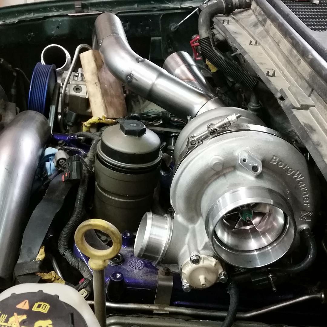

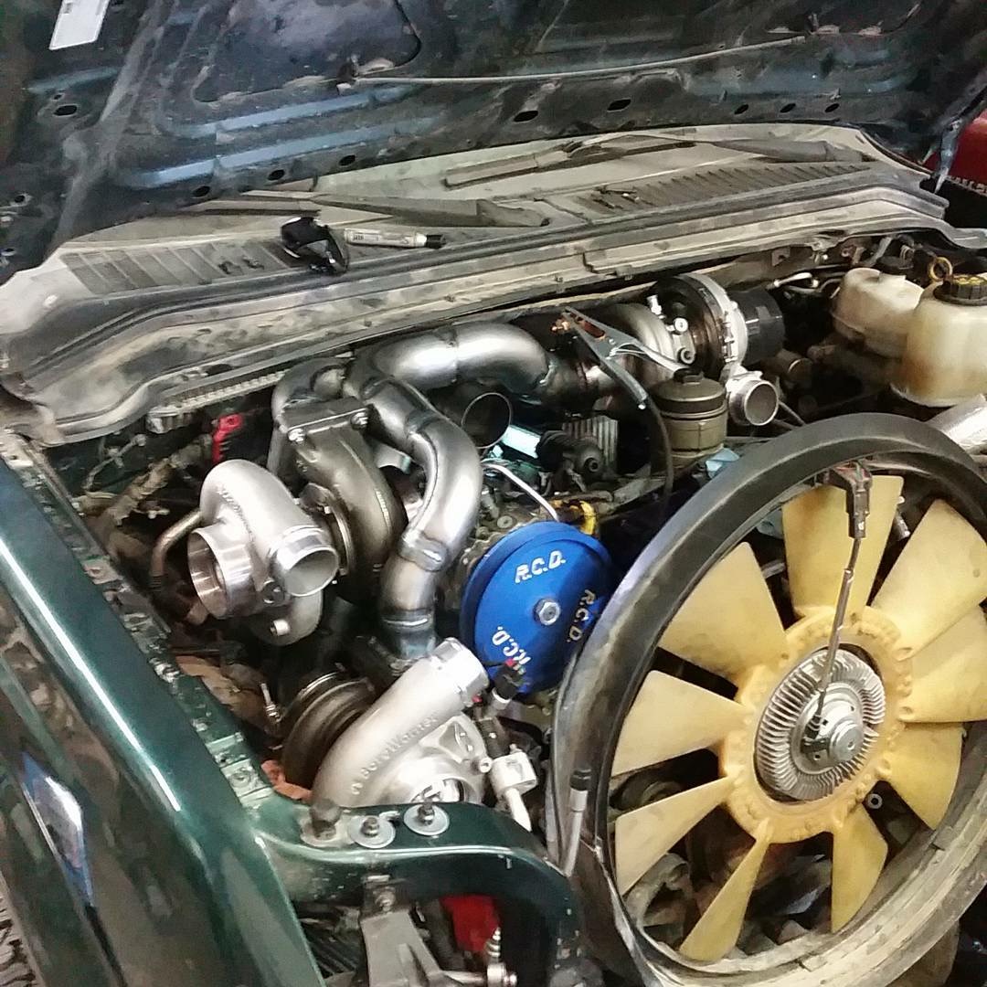

well this thread is kind of a feeler on parting out my newly acquired 6.4 triple turbo setup 6.4 and getting more details on it since im sure there is people on here that followed the build. I picking it up from a local guy that bought it couple weeks ago thinking he could DD a 1200hp truck and has left him stranded 3 times already and just got way over his head on the entire deal. So now headache to deal with. It has a pair of s369sxe feeding an efr8374, cp3 with 100s and a john wood 4r110 in it and more then likely going to just part it out. I am more then happy with my non VGT compounds and dont want to play in the triple game. So the purpose of this thread is to get more details on the build and try to figure out why a dealership found this truck in an auction when someone paid well into 6 figures to get it built.

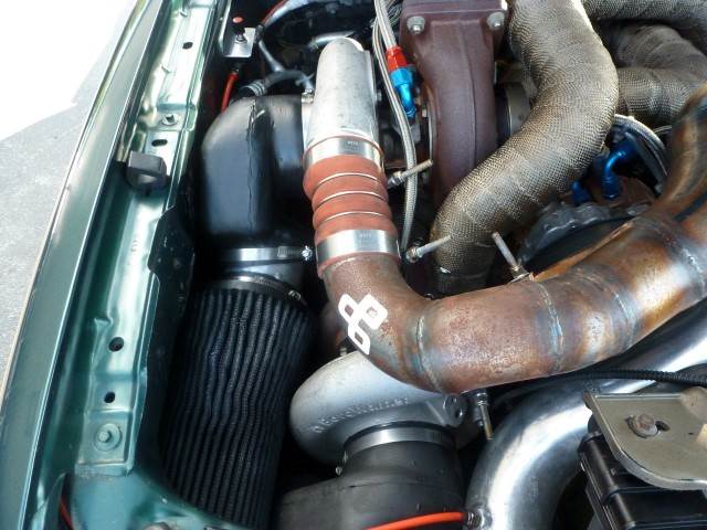

Wow lol. I know triples are cramped under the hood of fords... but damn!!
1200 ? and damn thats hideous under the hood .

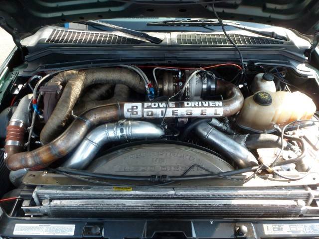

Yes the actual craftsmanship of the charger setup is very impressive but the installation of the setup is terrible. kinked lines an just looks like it was slapped together. thats why i was hoping to get the rest of the story cuz it feels like i am missing something.

Jon Schumacher built it iirc. The owner of the truck bailed on the build 3/4 of the way through hence why some stuffs probably not the best put together.
