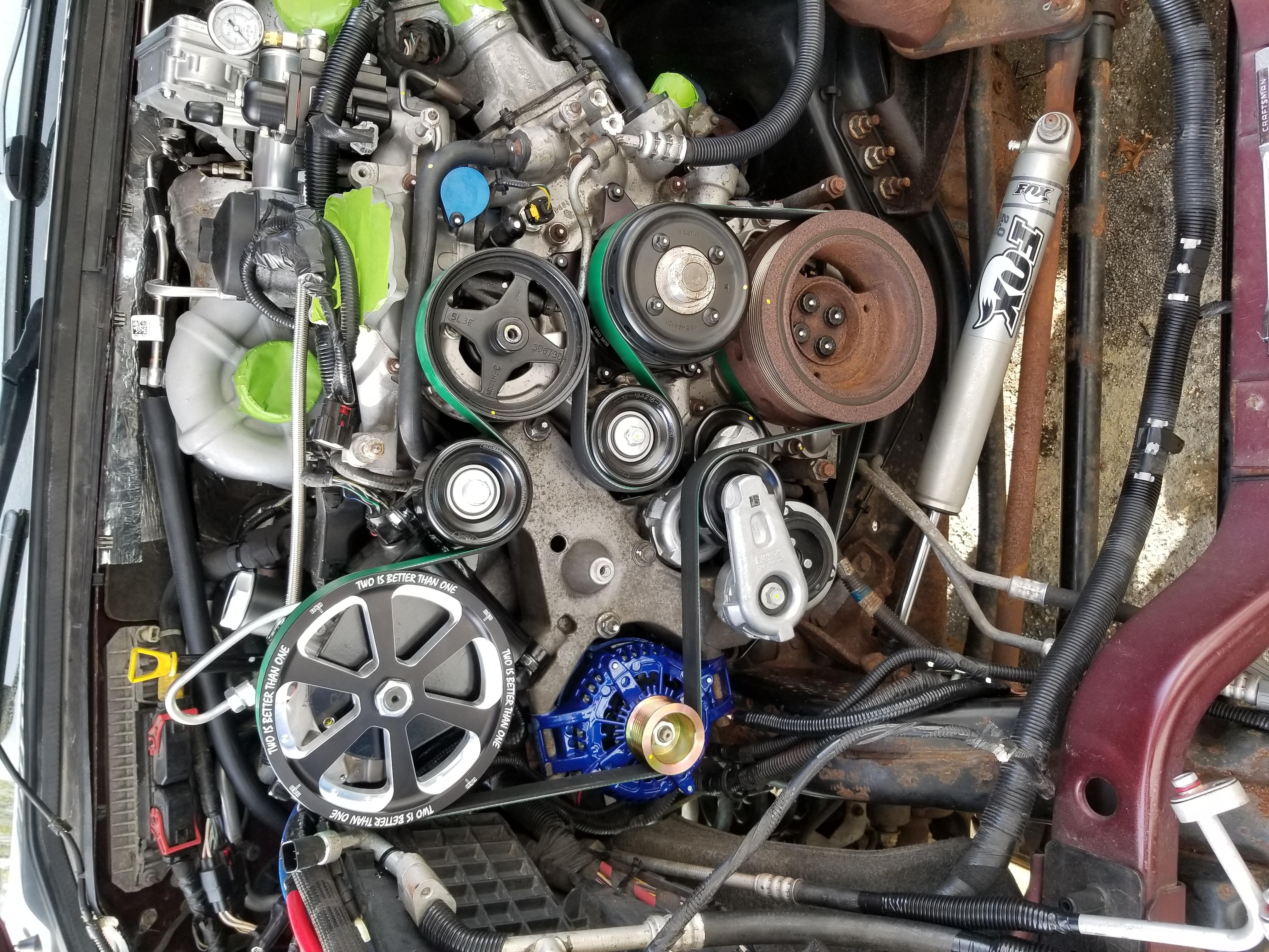

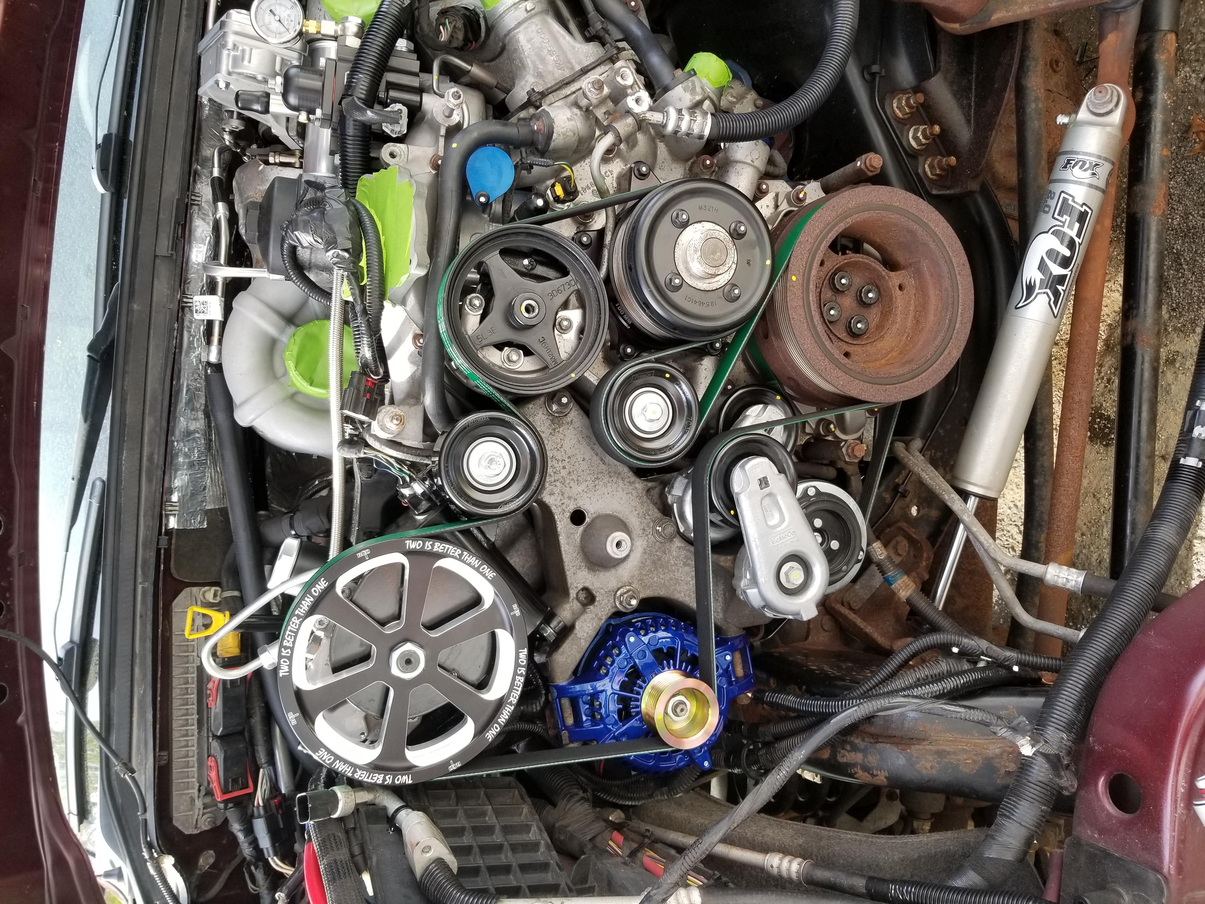

Ok, so as it turns out RCD did send me the right belt! Shame on me for routing it incorrectly.. Now I have a question to ask the members on here some of their opinions. Whether you know 6.4s or not chime in. Im going to post two different pictures with this of two different belt routing options. Share which one youd prefer and why.

The second pic is more of the stock routing on all of the other pulleys. I’d go with that

Thank you for your input! I definitely prefer it as well more stock on the routing. Some engineers were paid well to figure out the amount of wrap required on these pulleys given the amount of force within the tensioner.
