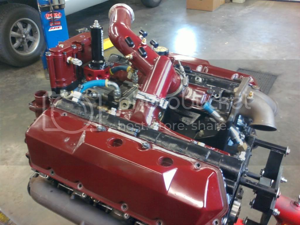

As you can see in Dave's photo he has it installed. It is located under the reservoir.

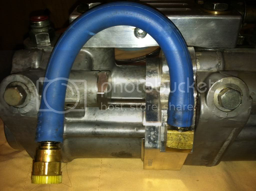

Half inch 8an pushlok for the rear pump feed, and I guess go with big bores advice for the return. I have obs jic hoses on my truck I simply do not trust the stock stc hoses.
Do not use a barb/ clamp style fitting anywhere. It might hold for a while, but it WILL leave you stranded when you least expect it.
Pushloc or Aeroquip reusable.
