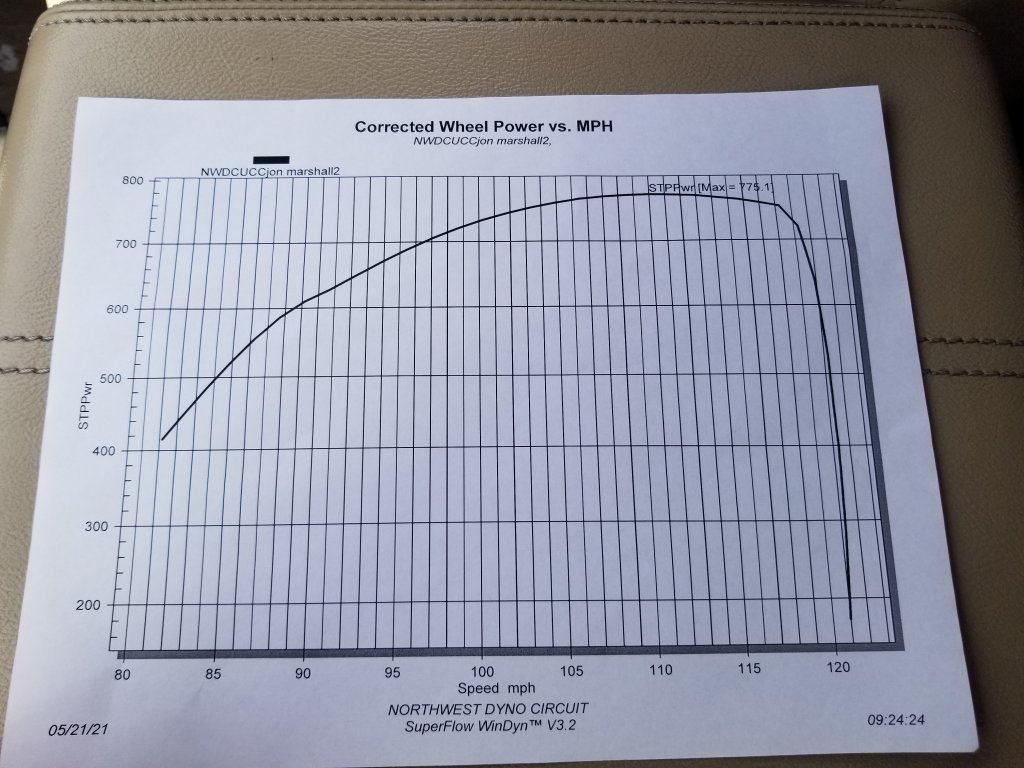

Feel free to DM. Any help at all is greatly appreciated. Truck currently sits at 775HP and 1500 ft lbs of torque but really need to dial it in.

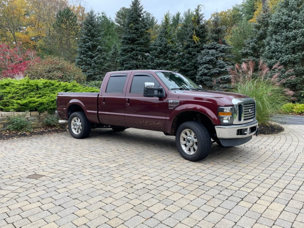

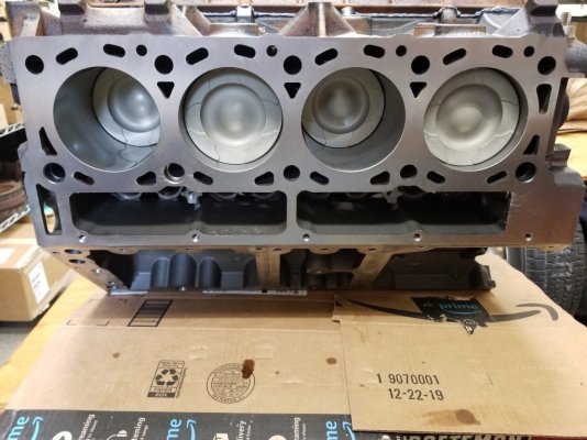

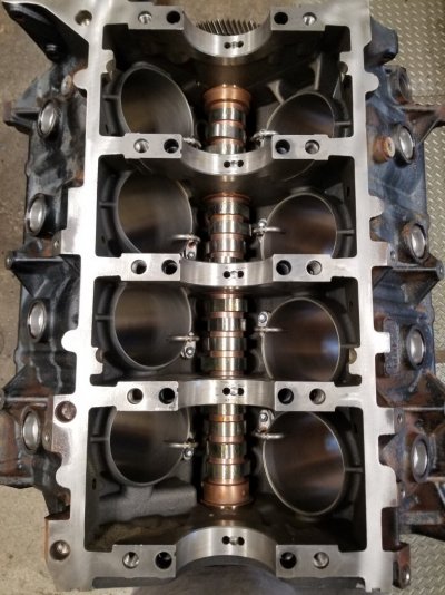

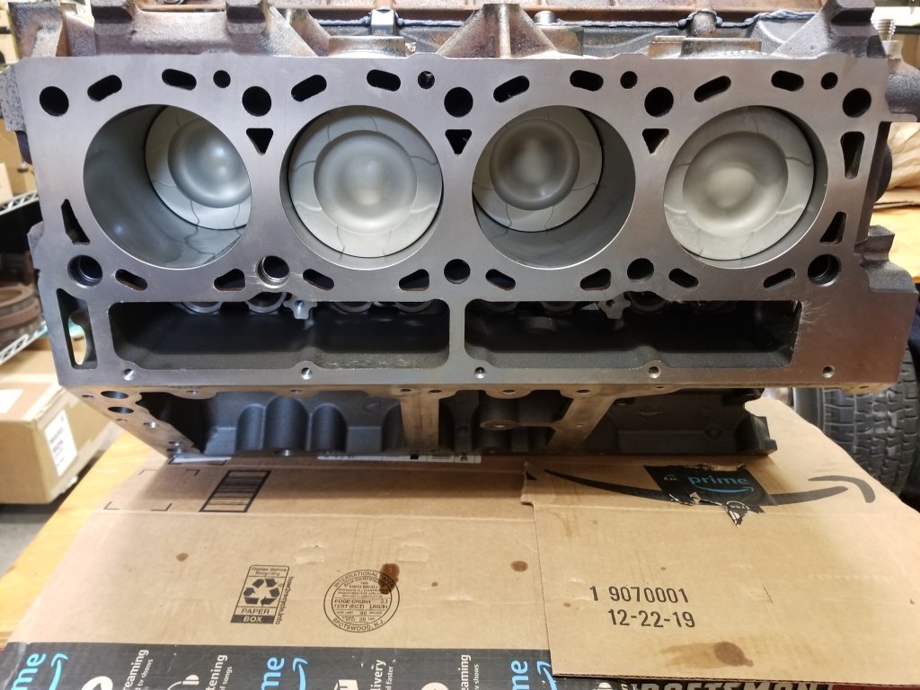

I think the truck deserves a post all on its own to describe the build. But to give you an idea, i would say its a true stage 2 build. Engine has been rebuilt(my garage) .010 over, HD delipped flycut coated pistons, stage 2 billet cam, billet pushrods, bulletproof diesel waterpump, KDD oring heads, 100lbs valve springs, 59mm/72mm turbos, tank sump, fass lpfp, dual fuelers K16/CP3, regulated fuel return, 60% over injectors, ported fuel rails, new rocker assemblies, billet manton valve bridges, ARP studs or bolts throughout(heads, bedplate, connecting rods etc...) all sensors and internal harnesses updated, normal weightloss components youd expect on a race truck, warren full billet transmission, billet flexplate, cci 5" aluminum driveshaft, pmf traction bars. Mishimoto radiator, intercooler, trans cooler, ccv reroute/catch can and their cross member support.
