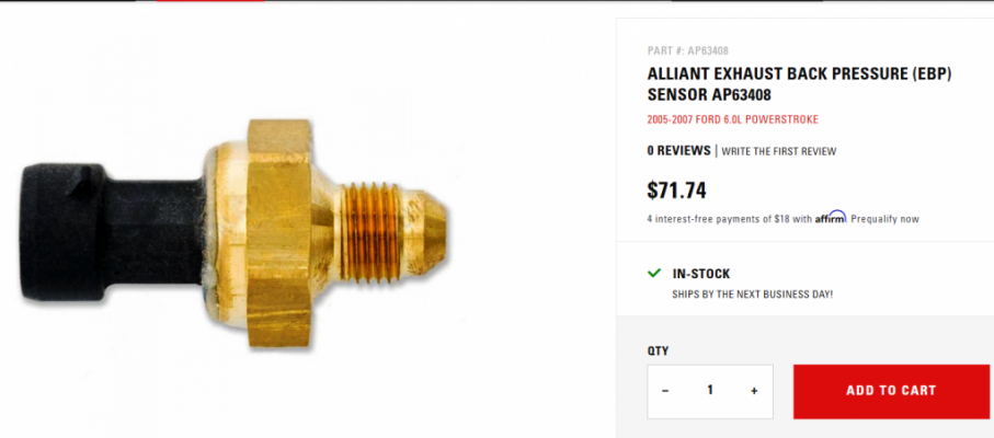

Anyone know what size the flare fitting is on the late ebp sensors? It’s looks like an, but it’s bigger than a -4, and smaller than -6, and I don’t think they make -5. Put an extra ebp tube on my truck to monitor actual ebp, and need to adapt to 1/8pipe for a sensor for the edge monitor.

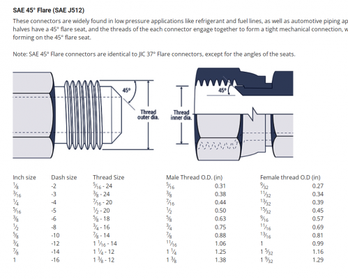

If I recall correctly it is 5/16 SAE flare. or Dash 5 EP sensor.pngsae flare.png

Thanks man. I had figured -5, but didn’t think they made it. I’ll try a 5/16 flare. Appreciate it!

So got my fitting in last night, the 5/16 flare works. Thanks for all the help.
