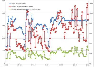

See attached log from cruising into work this morning. I can adjust the chart to zoom in on things if you would like. It does not look like i logged throttle % though. I am not sure exactly what I am looking for in this one so any insight would be great.

that is a lot of oil obviously but should still have a haze out the tail pipe if its not on the ground or leaking anywhere on the motor then it is being consumed. take oil cap off and flip it over and set it on the fill tube at idle. if it flips off then there is excessive blowby but that is still a lot of oil missing... so im sure orings are needed regardless due to the mileage on them..
and i hate rotella anything. put some chevron dello 15-40 in it and try that...

Back years ago I replaced injector O-rings because I started getting oil consumption. I made the mistake of not going back with the Motorcraft O-rings, and within 400 miles all 8 of them failed. The truck would gulp down 5+ quarts of oil in 30-40 miles. Zero.... I mean ZERO, smoke, haze, etc. You would have never known it was burning oil until the engine shut down because there wasn't enough to fire the injectors.
The OP is losing 7-9 quarts over the span of hundreds of miles. He isn't going to see any smoke.
