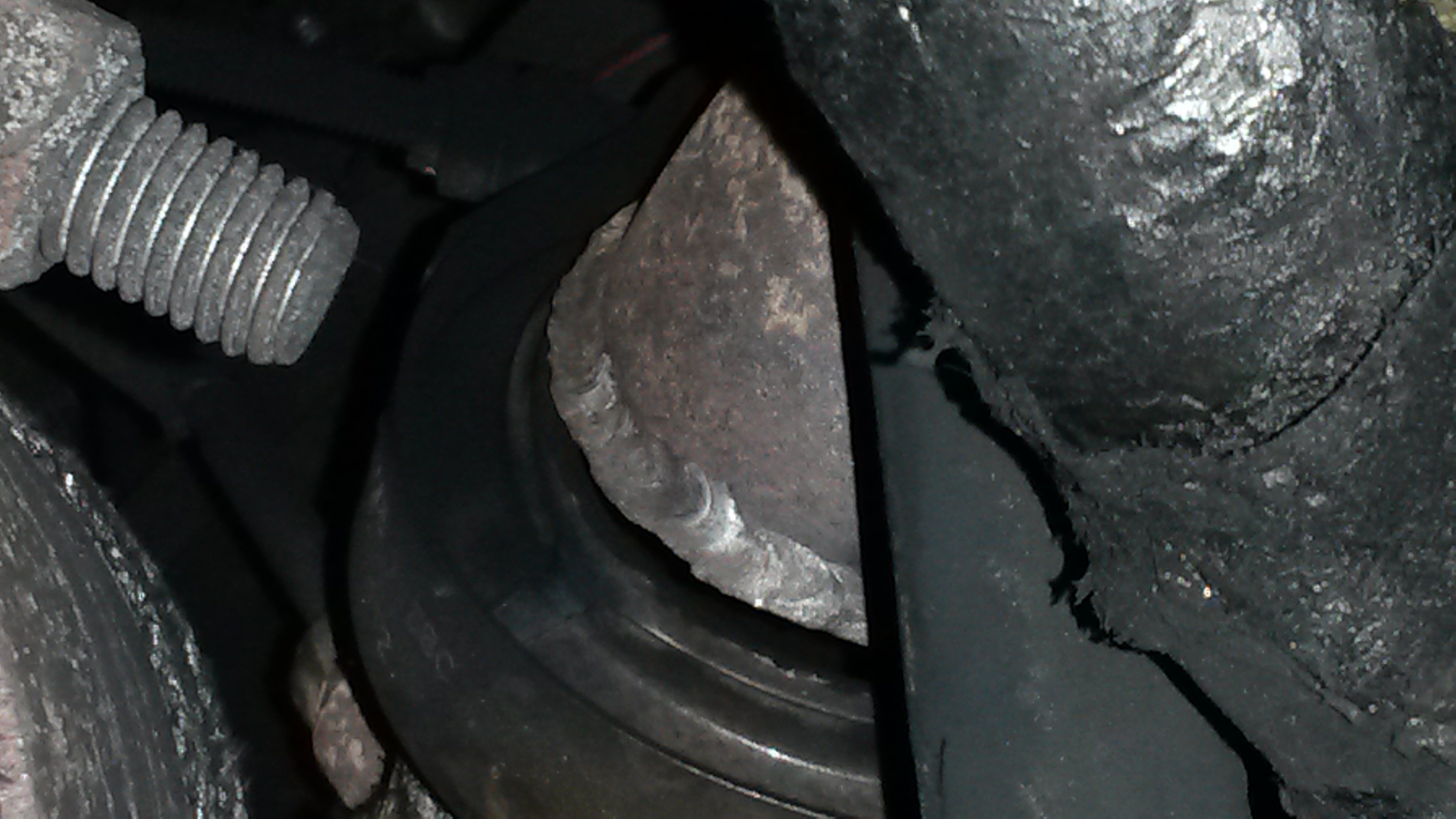

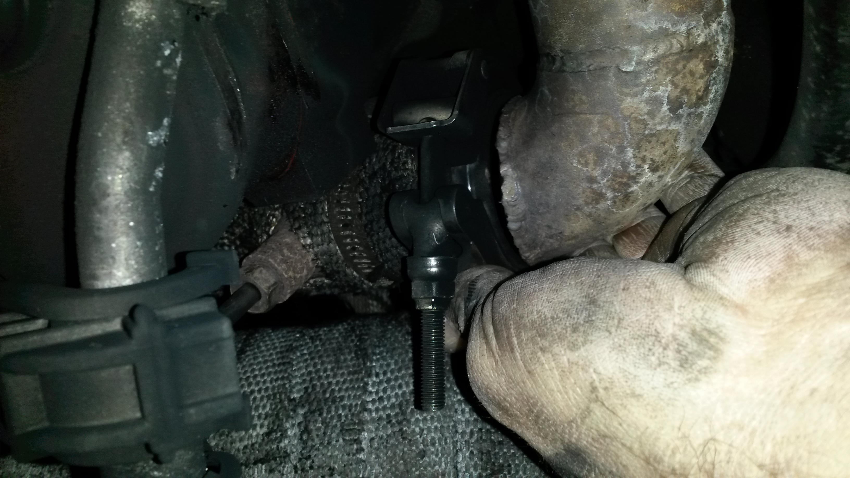

There is also MPD log style , I've ran for a few years , but my truck is sitting at the moment as I am in the process of removing my passenger side due to a Crack, other then that I've been happy
They are nice, but to my knowledge no longer in production. The RCD 6.0 manifolds look killer for sure. For the price it is really hard to beat the BD manifolds though.
