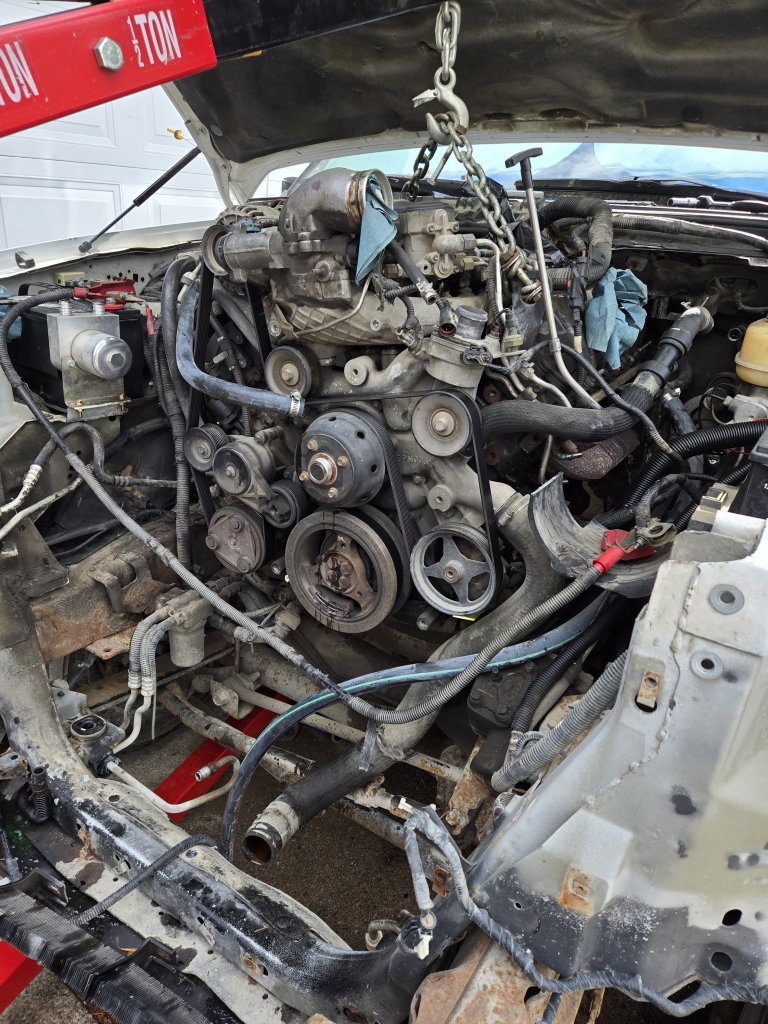

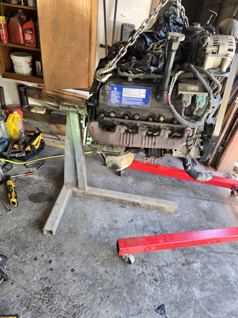

Can't help a bunch, but we just used a standard cherry picker with a log chain hooked to the front and rear lift hooks on the engine. It will bend them a little but it came out.
The up pipes, turbo have to come off. FICM, FICM bracket. Can't remember if there was anything else.
This is the second time it came out. First time was for heads and studs. This time it is going into a different vehicle. Going to fix some oil leaks.
Have the same debate about injectors, but honestly replacements are questionable quality. We are just going to wait.
