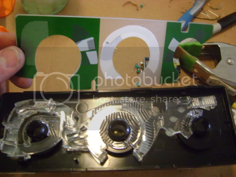

After your cluster is bare you can now SLOWLY peel off the gauge plate. Once again slowly.
Now flip the plate over and you will see the white parts that are on the back.. Those are actually green underneath and that is what is making you gauges green. You can do it how you want but I took a palm sander and sanded the green parts off so that whatever light is behind will show through as is. You can use a flash light to check the spots that you missed.
Be sure not to sand the black part of any of your warning lights because the light will show through right there. After your happy with your plate re-install everything except for your needles and the clear piece on the cluster.

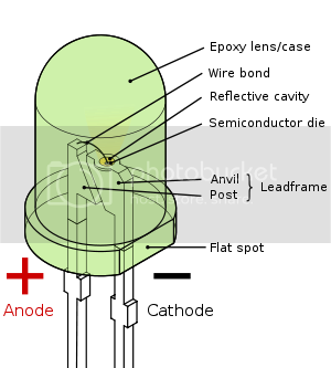

Finally you are to the easy part, replace your dash lights by removing the light socket and pulling out the old bulb and replace it with the new LED. Remember to pay attention that LEDs are positive and negative unlike the conventional bulb. Your going to have to install the lights and test them before you put everything back in place.
