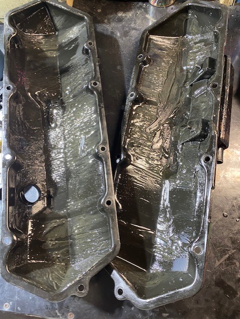

Hey Guys, I'm wondering if anyone has seen this before and can direct me which way I need to proceed here. Let me begin by saying that about 4 weeks ago I had done an Oring job on my injectors after a no start condition had presented itself and my diagnoses concluded that my injector Orings were bad. I pulled the injectors and sure enough 7 out of the 8 injectors had some pretty bad O rings on them. I did have this goop on the valve covers, but since I had applied Compressed air to the head, I figured that the goop was attributed to the compressed air and didn't think to much of it. I cleaned up the valve covers and I then replaced the injector O rings assuming that I had found my issues but still had a no start. After this, I then replaced both iprs (BTS Hpops) and at this point Hallelujah, she fired up. So I'd been driving the truck around for the past few weeks and on Monday I went out to start the truck and once again experienced a no start condition. I got the Forscan out and pulled codes 1212 and 1280 which pertain to the ICP. So once again I figured I'd go ahead and pull the valve covers and see if maybe on the reinstallation process I'd missed something and this time once more this is what I found, a slimy goop that was stuck to the valve covers, just like last time. No where else in the head was this slimy gunk present, just on the valve covers itself. It does appear to be a mixture of water and oil for sure. My degas bottle was a little low, but I also have a very slight leak from a rubber expansion plug that I used in place of a brass expansion plug after my last repair. Thats a story for another time.

I'll post up some pictures so y'all can get a better idea of what I'm seeing. The picture of the valve covers is what really set me off about a possible problem. The next picture is of the driver side head. The following day after the truck sat all night, it was at this point that I decided to take a very bright LED flash light, and began poking around in the head to see if something would jump out at me. Well it was at this point that I was able to see the small puddles of coolant in the bottom of the lower portion of the head. Again, it's not a lot, and the fact that I don't see coolant in my oil I believe is a good thing. I pray that I caught it in time and that there isn't any internal damage. Hopefully it's nothing more than the oil cooler, or cavitation at the water pump.

DMD mentioned it earlier. That doesn't look like coolant to me in the pictures but it can be hard to tell. Coolant is usually whitish to chocolate milk and sometimes frothy. This looks more like condensation from short drives? How is the crankcase ventilation system? Is it factory or vented to the atmosphere? It may not be a bad idea to have an oil analysis done to see if it indeed is glycol?

Only times I have seen that goop under the valve covers is a cracked cylinder wall.
