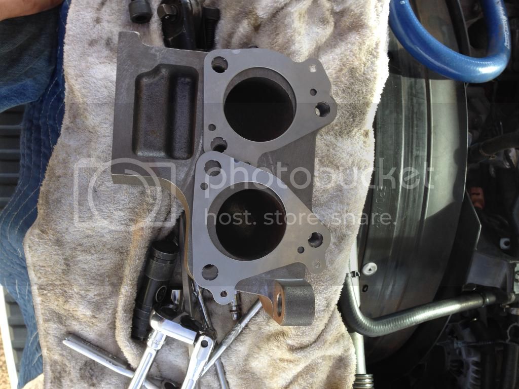

See pics below. I'm installing my MPD turbo kit after finally finding time and hit a dead end. Looks like I have the wrong exhaust gaskets where the manifolds attach to the pedestal. One gasket seems to line up but the other is far not lining up at all. Did MPD send me the wrong ones or am I doing something wrong?

Wow that is odd, those gaskets are not supposed to be different. Looks like gm sent us the wrong gasket and was over looked, cant rely on anyone now a days! Call me monday and i will send you new gaskets.

Yeah, I didn't know you guys were open on Saturday so I posted this in hope for a quick answer. Talked to Bobby and he's gonna overnight me the correct gasket ( the lower one on the first pic). Gonna call on Monday anyways cuz I have a couple install questions but since your here maybe I could save you guys the trouble on Monday.
