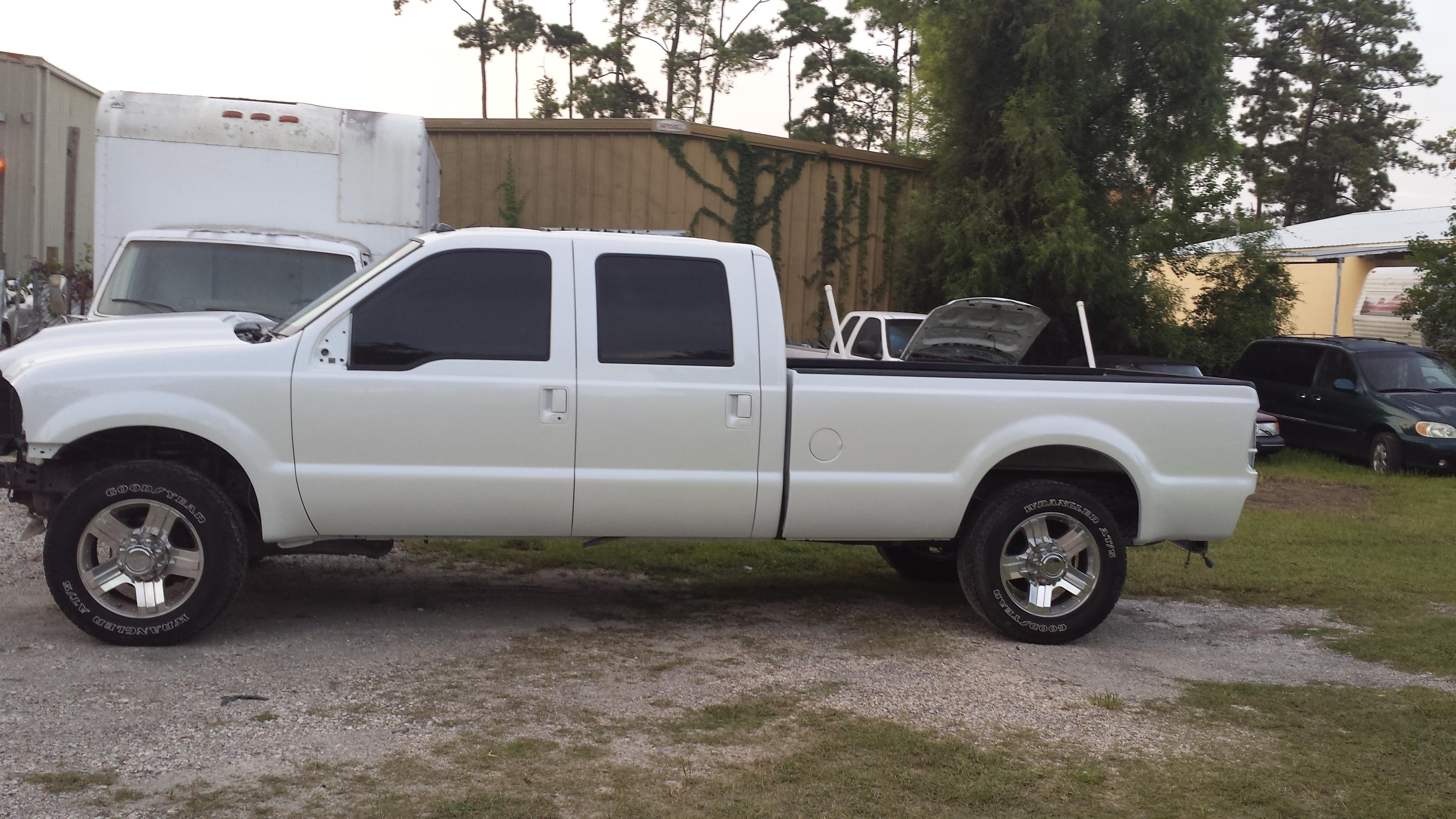

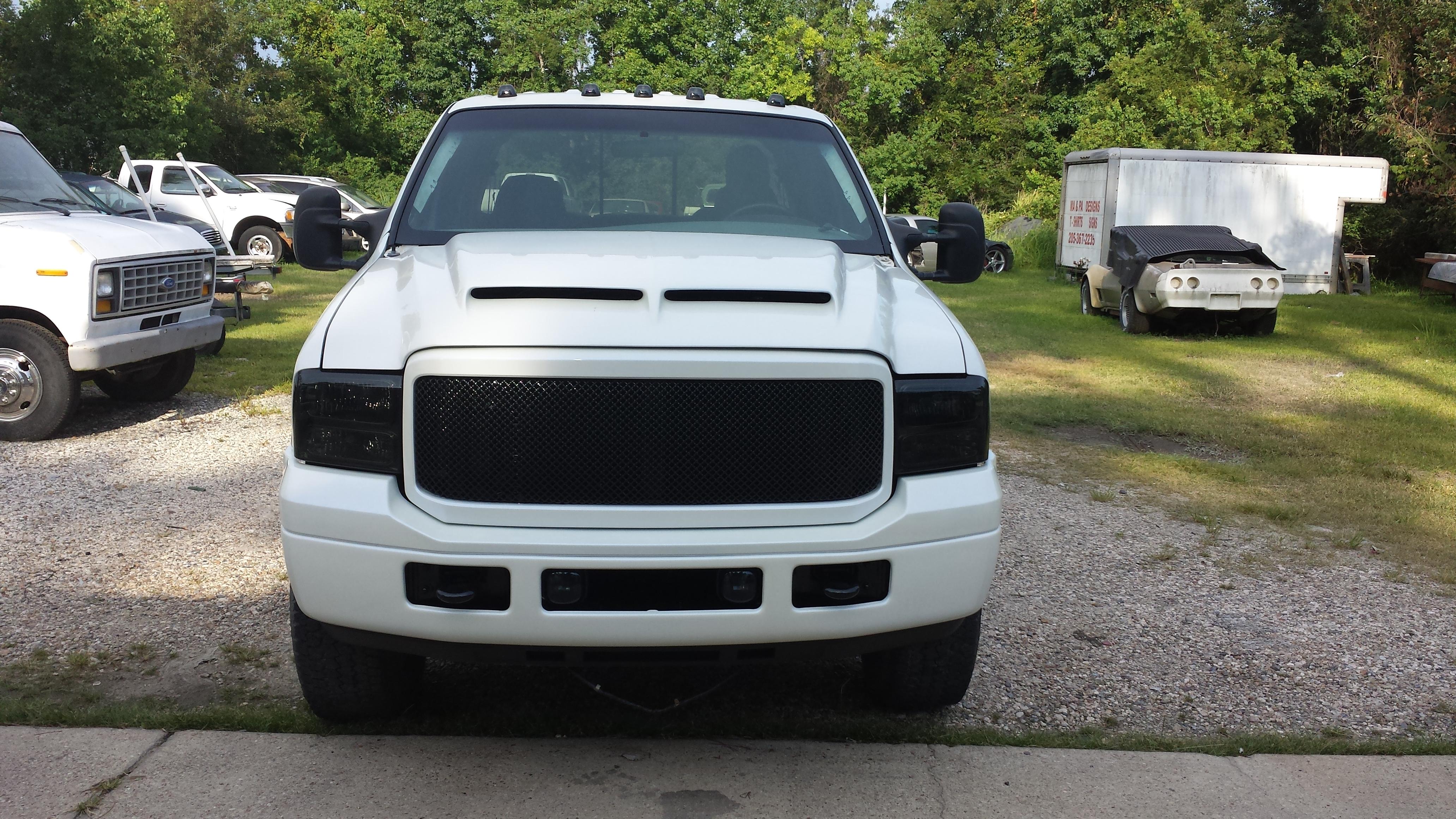

Okay got it done shocks worked but can't go any higher with these. I don't off-road so no big deal. I'll be buying some Fox 2.0s soon anyway. 5.5" front and 7" rear with a set of 38" Toyo MTs. They rub pretty good so I'm about to pull the trigger on some 37s 15.50s are just to wide for this lift. I knew they would be but got a killer deal on the set. What do you guys think?

Wow killer looking truck. I have a white 08 CCLB, I'd love to go that sleek.... I have some paint chips and small dents that are getting fixed in the spring, and then the door handles, but wow, your truck is gorgeous. You have any more pics?

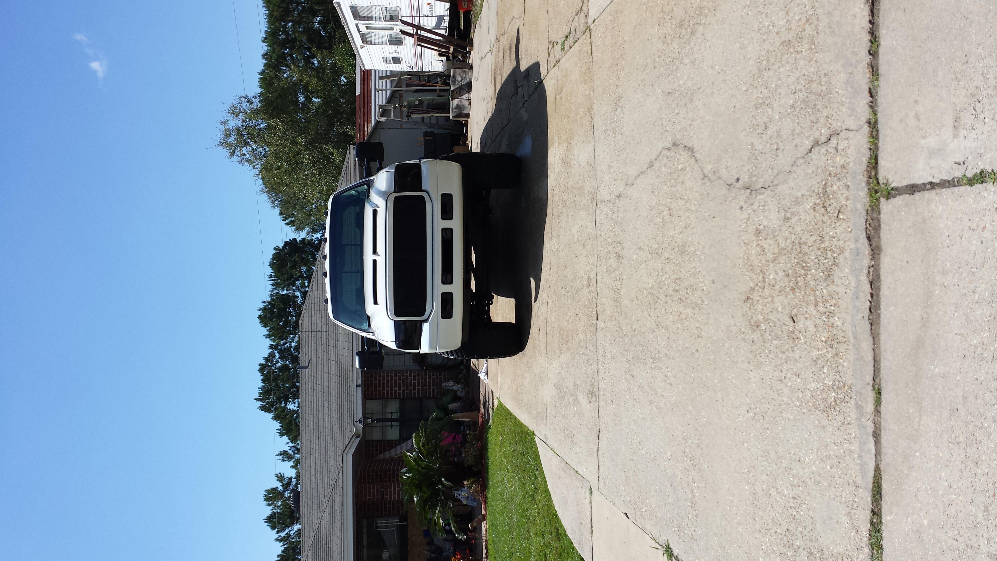

I just found that procomp has some reasonable rear leaf lift options. So i can get rid of my stacked rear blocks... :D Here's what it looked like 10 minutes after I put it on... It settled a little of course, and this pic doesn't really do it justice, but the second one I think you can see kind of what I'm talking about... Although that was just a good picture, it leans more than you can see. That duramax is at 6 inches, just for reference...

That will look good when your done. I love the wheel offset. I've always loved the 08 front end but couldn't afford one when I bought mine. It's my baby though, I bought it as an xlt so I have done tons of work to it myself. Slowly but surely get it how you want it.

But your truck has soo much "sleekness" which is kinda what I'm going for.
