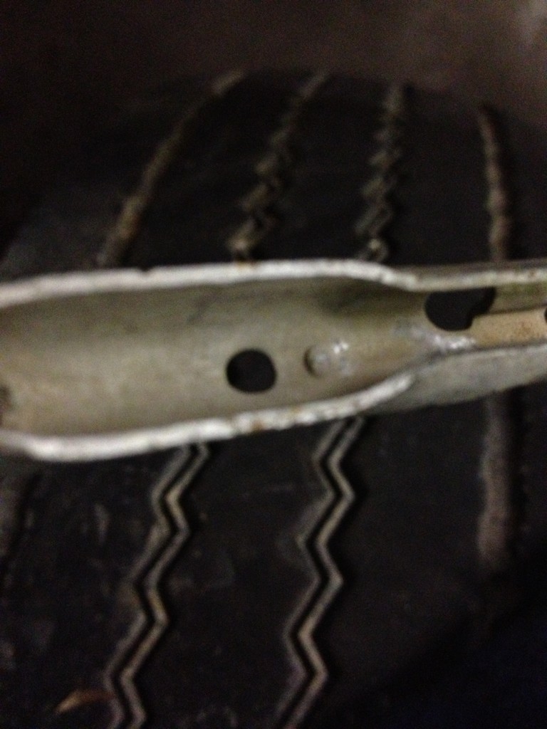

You can disconnect it underneath as well. Probably much easier as well. Look for this right under the drivers feet under the truck ImageUploadedByTapatalk1393626482.598287.jpg
Sometimes the little nub sticking up needs ground off to remove the cable just depends how stuck it is. Wd40 helps a lot too.

You can disconnect it underneath as well. Probably much easier as well. Look for this right under the drivers feet under the truck View attachment 26363
I noticed that but I don't know if there will be enough slack to remove it. It's kind of tight already with the brake disengaged. I'll hit it up with WD-40 and see if my cousin can help me. Thanks sir!
Pull down on the cable and use vice grips next to the body mount to keep slack in it. I do it all the time raising cabs

as mentioned pair of vise grips against the body mount to hold the slack, some PB blaster to losen the connector between the cables, and I use a flat head to pry it open enough to slide the cable out
